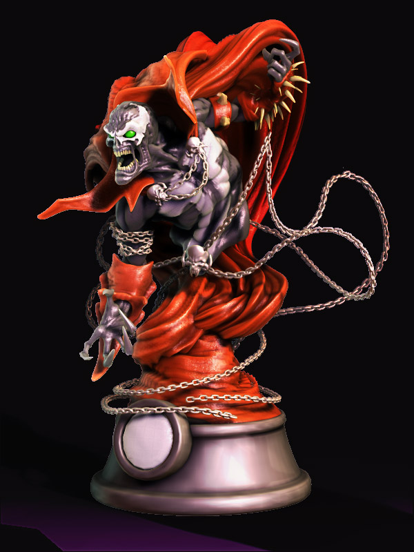

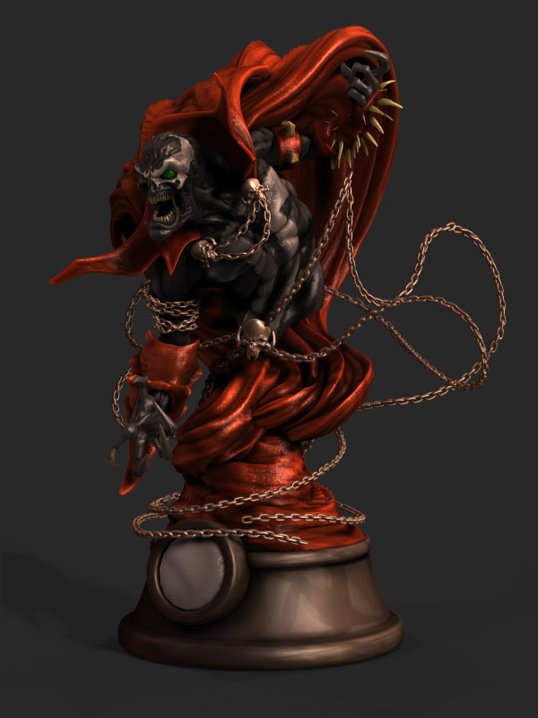

As I previous said the final image was obtained composing three different zBrush Renders in PSP.
The one I used as “base” uses caplight and one Light:
The lightcap was grabbed from a pictture of city during a sunset; the photo was goggled and you can find them under LIGHT->BACKROUND.
I’ve modified one caplight with Alpha… you can see the final lightcap under LIGHT->LIGHTCAP.
To obtain the render I used as a base you have to:
- disable Light1 and Light2 from LIGHT
- disable all BPR filters

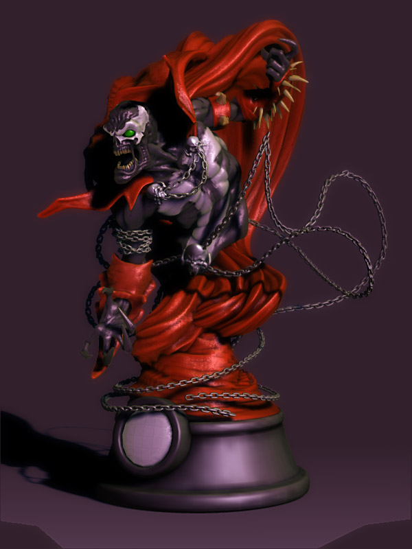

The One I used as Main Light:
To obtain the render I used as a Main Light you have to:
- delete al Lightcaps (LIGHT->LIGHTCAP->DELETE for all caplights)
- Enable BPR filters (1,2,3,4,5 and 9,10,11)

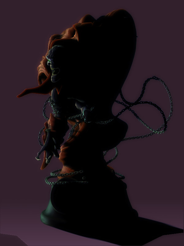

The One I used as Rim Light:
To obtain the render I used as a Rim Light you have to:
- disable Light1 (LIGHT-> deselect the first light)
- enable Light2 (LIGHT-> select the second light)
note: also this render don’t use any caplights and uses BPR filters (1,2,3,4,5 and 9,10,11)

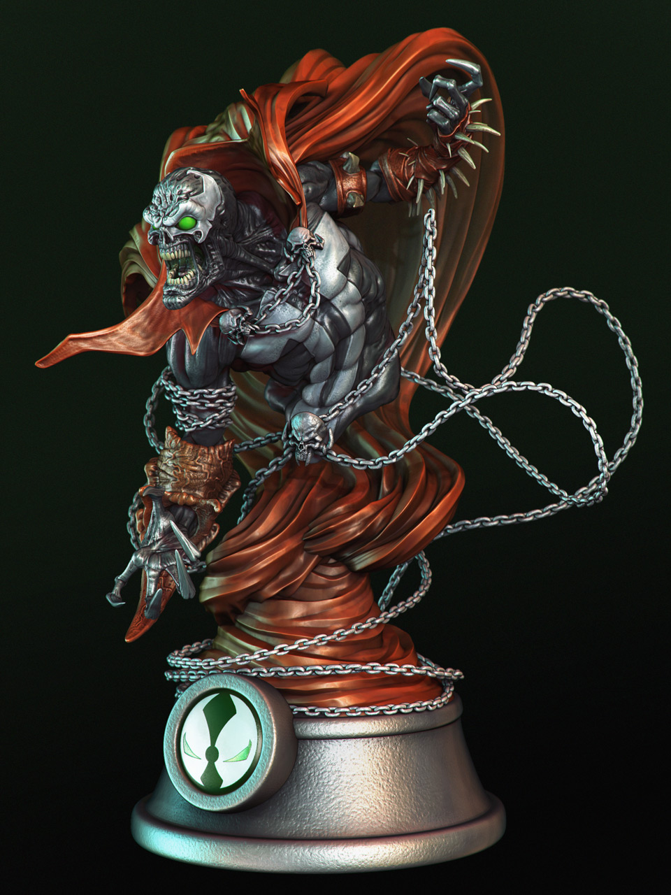

As I mentioned in the preceding post, this work was done in order to partecipate to a contest.
In particular the contest was organized by www.charactersforum.com and is titled “My Superheroe portrait” ( yes is the same where Danko participates with the Joker that has already won the top row here on zBrushCentral)
If you are interested you could find very beautiful work in here
Here my final:
zBrush Render composited in Photoshop
