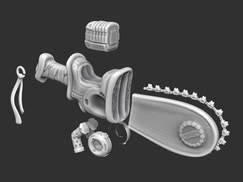

I get the chainsaw as example…
In this case I started whit very basic maded in XSI. From this I sculpted just to arrive to my desired result mantaining each element separated as a single subtool.
[![000.jpg|800x600](upload://qblwgaLVm3jY6KFEWaVAm6Y6iPL.jpeg)]![002.jpg|800x600](upload://jOuLIVUqgpWXzeCxwKHrdq3uxoH.jpeg)
Once I finished I exported one by one each subtool to roadkill to put the seams I wanted.
As I noted that whit some of these mesh RoadKill crashed I founded a correct workflow that I putted in a macro to save some time:
MACRO ExpRoadKill:
-Put the current subtool to the highest level
-Make Polymesh3D
-Reconstruct to the lowest level
-Save as “C:\myRoadKillDirectory\000.obj”
With this macro RoadKill was able to load every exported mesh.
imported in RoadKill I maded the seam and reimported in zBrush over the same mesh. I Checked that UVmaster worked properly with the “Use existing UV Seam” enabled.
At this point I replaced the old subtool whit the seamed new one.
The strange thing that I found is that when I do a merge of different subtools some time zBrush is unable to reconstruct the lowest level: this was my main problem. My solution was to use almost closed surface where zBrush seem to be more confident for Merge/Rconstruct operation. I will dig more on this…
Another thing that needs attention is to keep each subtools with the same number of levels: if the numbers of levels are not equal is possible that zBrush cannot reconstruct the lowest level for part of the new tool. In this case the UV and the seams are messed up.
So, for each new subtool I spent my 30sec to chek that the merge function woked properly.
Once obtained a correct merged tool, the RoadKill seam remain and once all subtools are ready is time to make the megamerge and use UVmaster on the whole mesh!
In my workflow I started painting on the model only after the UVmap operation.
I know that all this seem a bit too complicated, but these are very three repetitive things… I hope to be able to do a little video explaining this workflow in a simpler manner.
