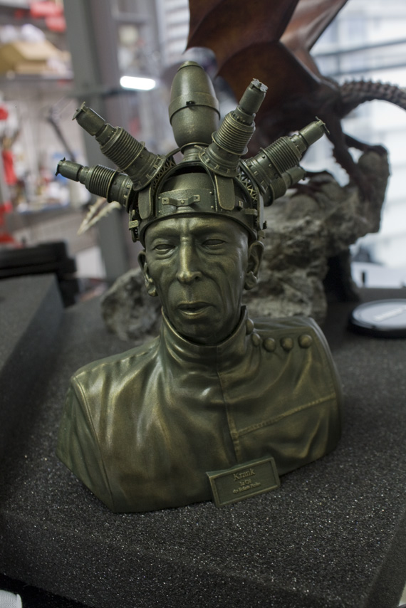

Did this Krank in a rustic bronze finish for Robert Vignone (need to do some wires on the brain drain helmet still… and oops… need to clean up that slight brushstroke on the cheek area).

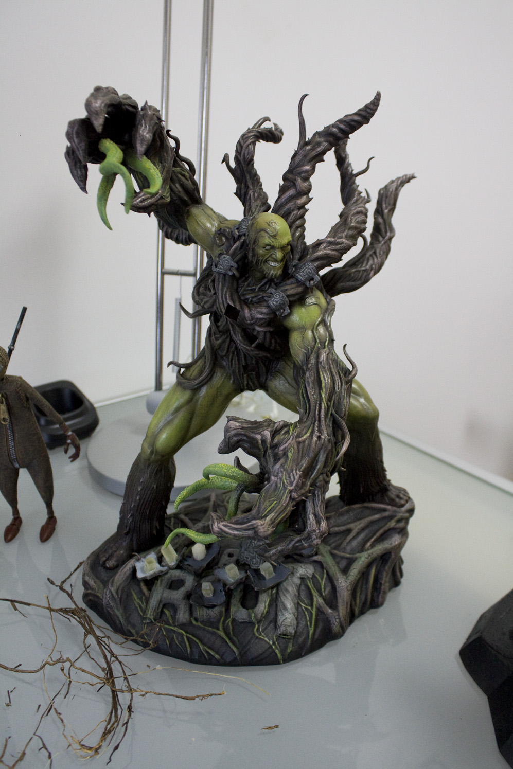

Like here’s a WIP of Dr. Root… this is actually partially glued together already (the original print was like 20-30 pieces). So if people give us STL’s or OBJ’s… it makes it hard to re-engineer the piece for a nice print.

Hey desmoda! Nice work on the Krunk’s “helmet”, I guess you made it in separated parts and then glued them together, as seem in the pic of Dr.Root.

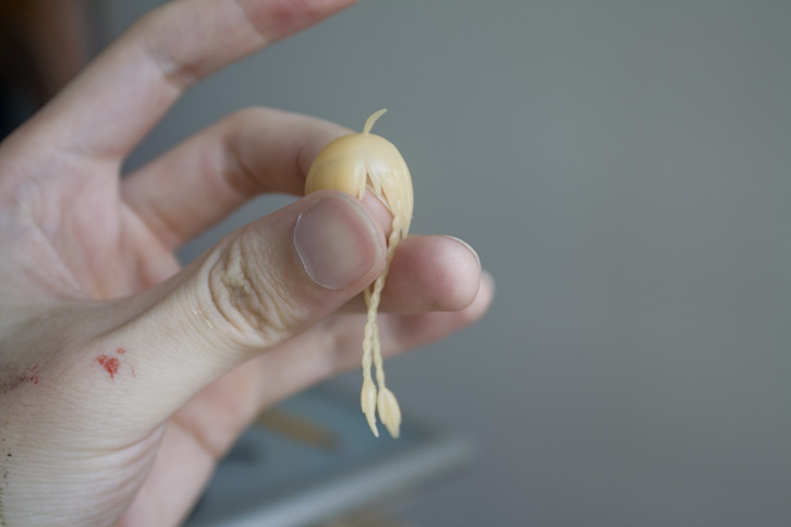

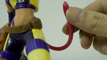

Also, I have a question that seems to not have been asked yet, what’s the durability of the materials used to make the prints? Are they easy to break or are they “elastic” or hard, do they melt with heat, etc? Just curious to know what could be possible to do, like for example, a character floating on top of the base and being held by a uhh… “hook”, like that Haruhi in one of the pics in this thread.
the standard print material is pretty delicate. about the 70% the strength of polystone. so its quite heavy but kinda brittle. also… 3d printing materials tend to be sensitive to heat and sunlight (excluding zcorp)… so please avoid these two. SLS and FDM materials are more resilient tho.
i have a couple materials that are indestructable… like you can run them over with a car and they wont break. But I’m probably not going to release those until I finish my current workload and update the website.
We also make vinyl prints on a case by case basis depending on whether it really needs to be that way. The reason being is that the faux-vinyl is not a true vinyl so normal acetone PVC paints don’t work on it
. Have to resort to silicone paints which are expensive and don’t have all the colors I need. Still tweaking it~ Hopefully we can get to real PVC~ I don’t see why not. I’m just lacking time to sit down and do it~

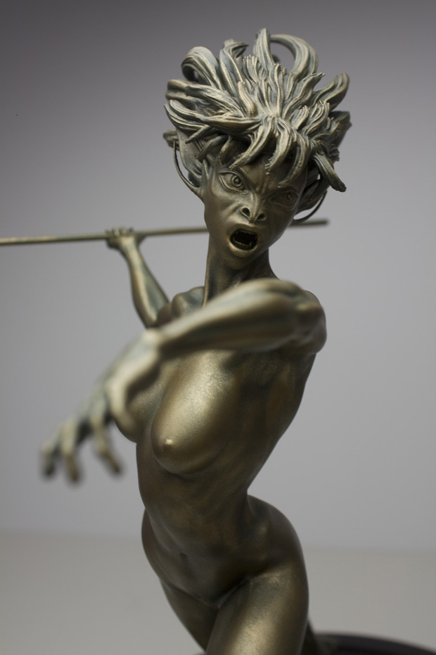

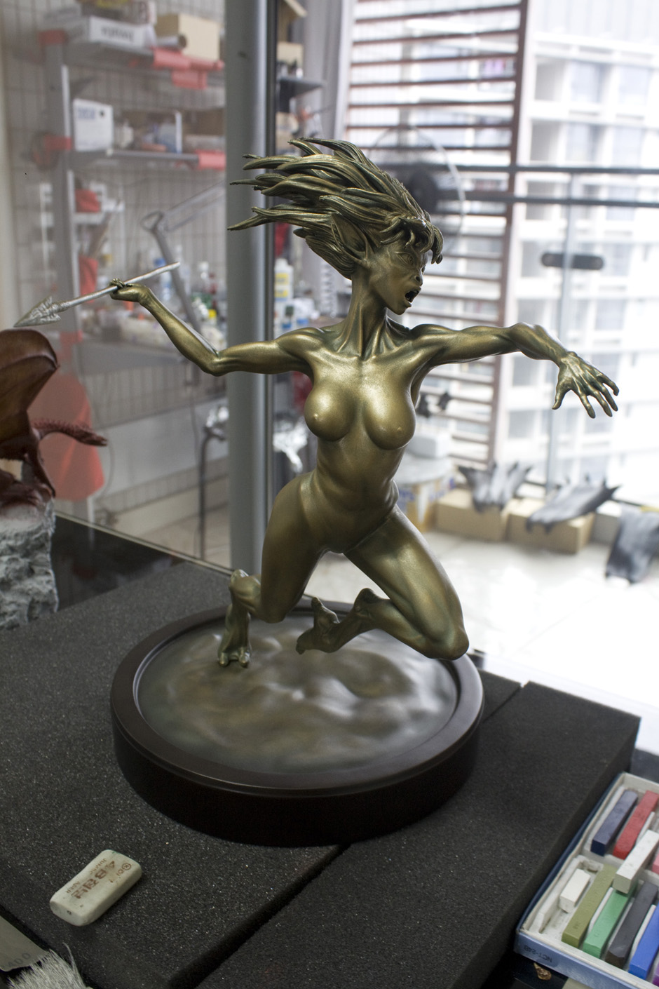

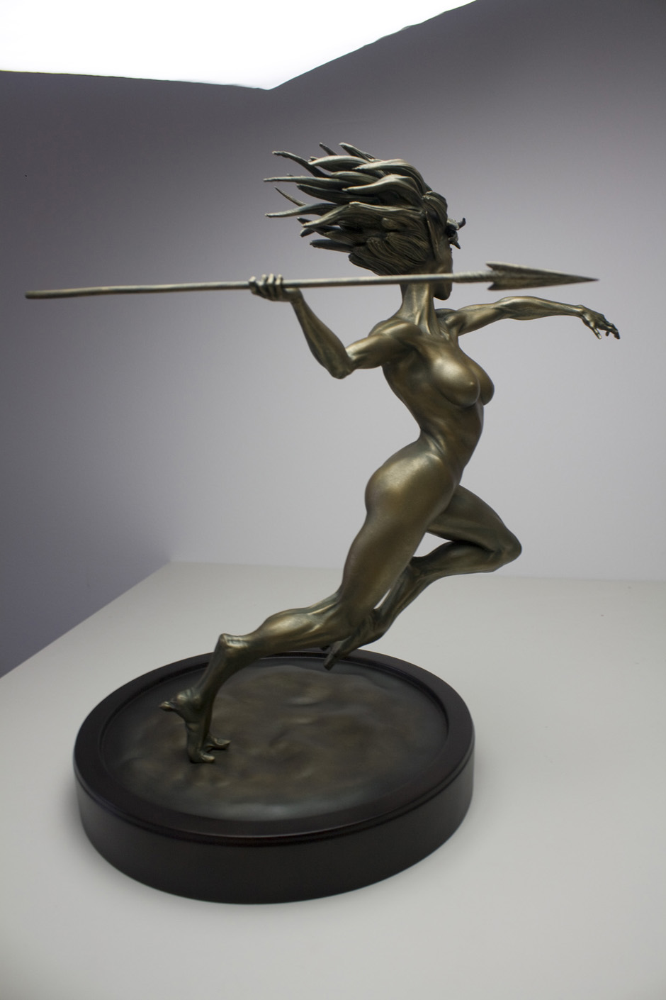

been practicing my faux bronze work cause i feel like thats the area that needs some improvement. here’s one that i did to mimic rs_classicbronze. was made by arman akopian i think for a personal piece (if not… oops… lemme know arman). some people tellin me that i need to learn how to do CS Moore bronzes~ that’s up for practice soon… (can’t believe I’ve only been painting for 10months… remember I’m a white hat software security programmer by trade… you guys should pick it up… its really fun). But my employees kinda frown when I do painting cause they think I should be focusing on software stuff and typical boss stuff like looking over their shoulders and hitting them with nerf bats~ So I do it on programming breaks~

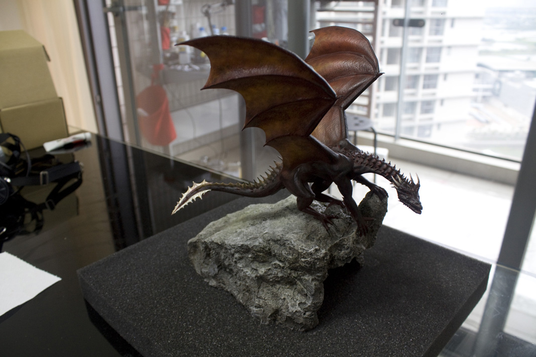

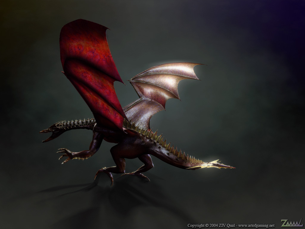

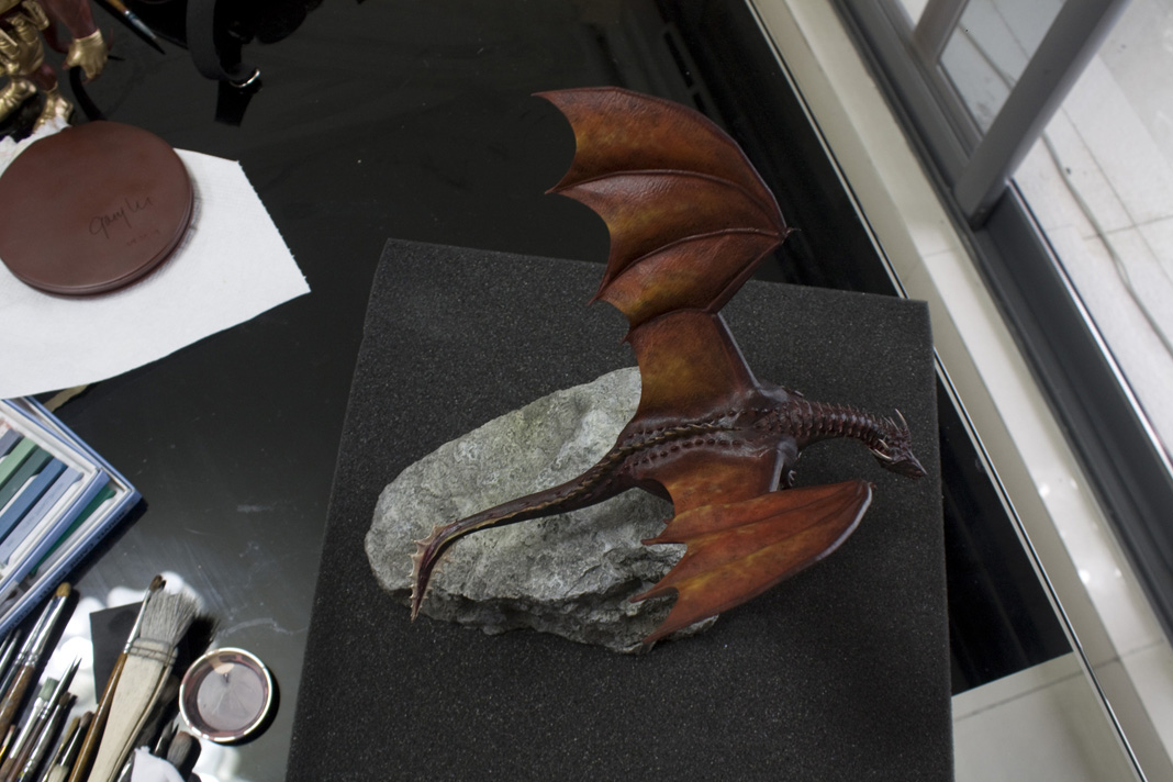

did a dragon with airbrush to practice making mottle flame effects on the wings. The dragon was a print for artist Ziv Qual (who promises me he’s gonna pick up zbrush… but he made the dragon in 3dsmax which meant I had to sit there forever and bake displacements in for him).

on the technical side… you can see that it’s kinda irrelevant how fragile a piece is cause we can always add metal to your piece (like the legs of that girl) so that it won’t break.
for the the dragon… i guess the only special thing about it was that I made the base by hand instead of printing it to save Ziv some money. plz don’t ask me to do this all the time though… its a pain in a butt. also… the dragon is not the greatest thing for mass production… would have to cut off a ton of horns and split the wings off and the bottom of the jaw off for casting. not fun.

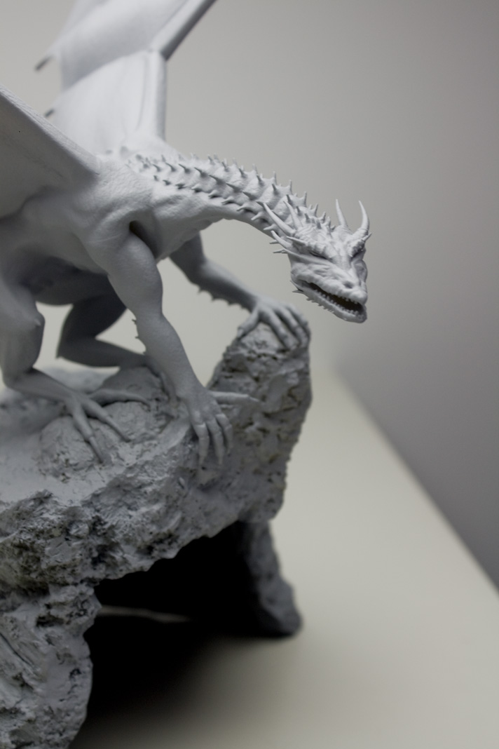

Out of curiosity… are the wings on the dragon translucent?
The bronze looks really well done… at least from pics you can’t tell its not actually metal.

Gareee… naw… the dragon was printed opaque (attached image). Just painted to look transparent.

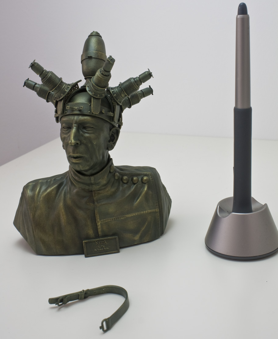

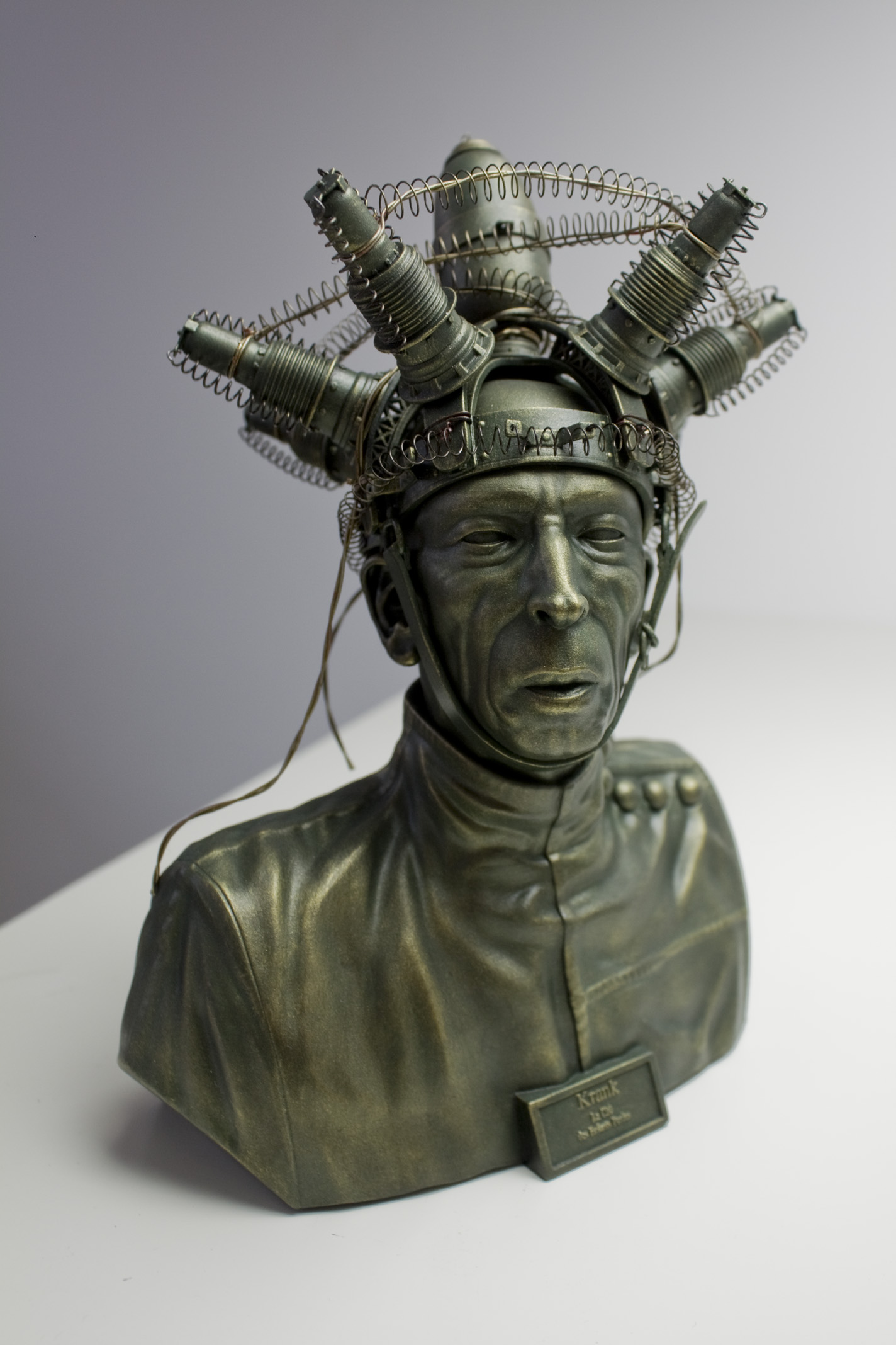

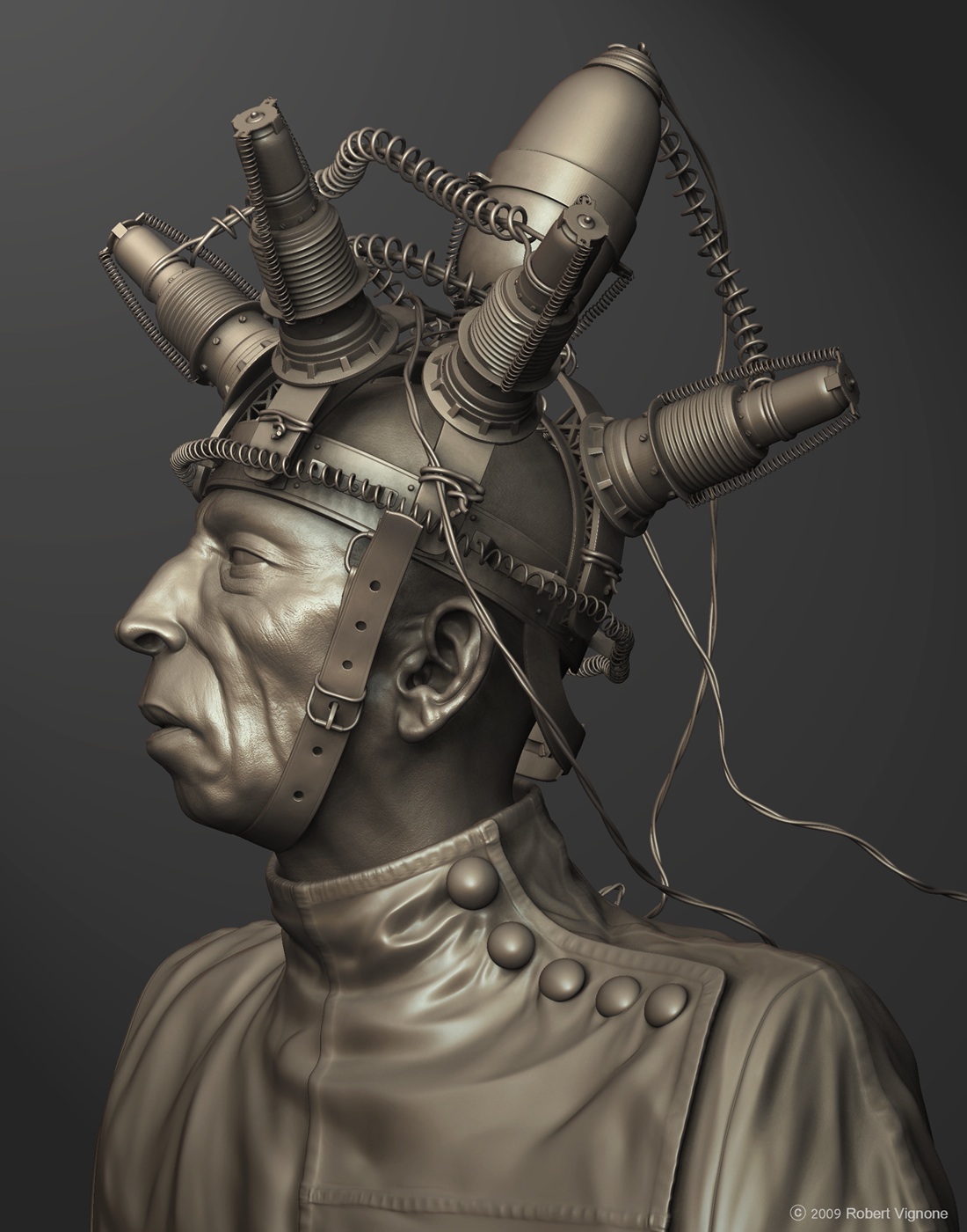

Okay… what can I update this week… hmm… finished those wiring for the Krank print… it’s not exactly the same… but i guess its close enough. Again… by Robert Vignone. Fixed that cheek glitch as well.

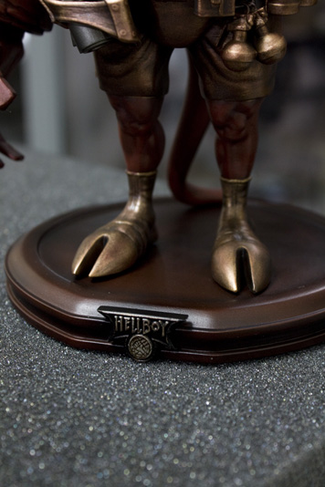

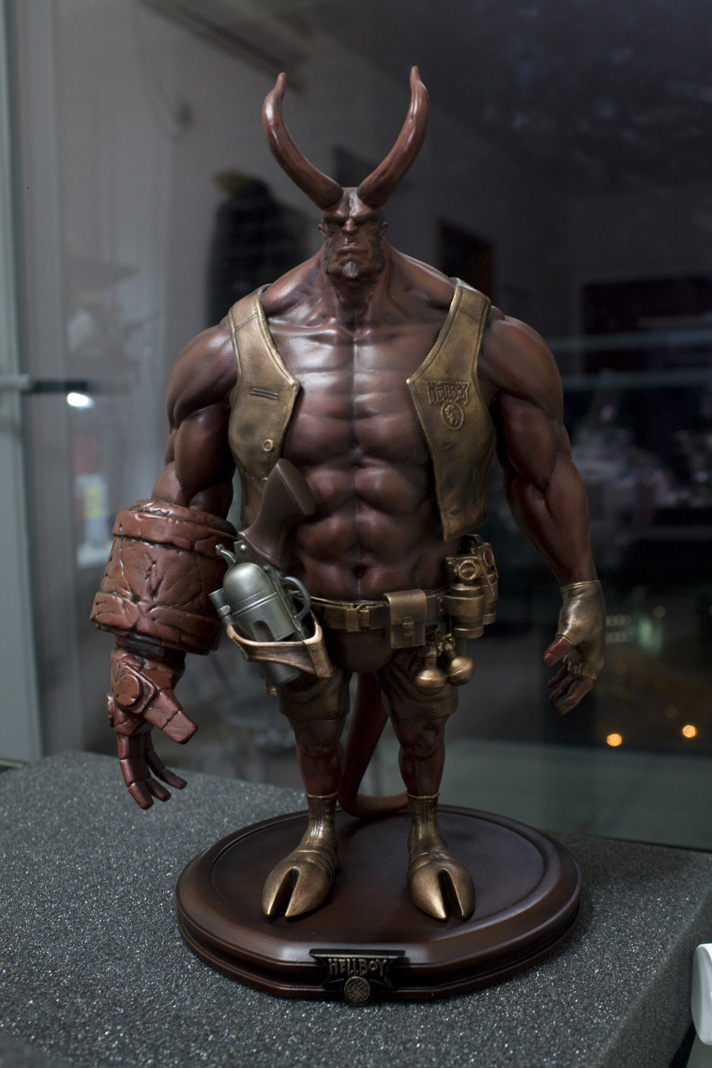

Did this hellboy for a personal piece as well for artist Gary Lee. He didn’t really know what he wanted with the paint… So I just did some kind of all metallic bronze thing but with a lot of different colors and shades. Turned out ok.

i’m so glad to see all these updates.
some pieces look really great, i’d love if you would post the scale when you show pics.
that city of lost children piece though is bothering me, you lost all the fine details, mostly in the face, i guess because its so small?
great job on the hellboy, dr.root and dragon.
zomfg!
Yah you’re right spaceboy… it was an 5.5 (top of helmet to bottom of sculpt) inch print that started off as an 8 incher but because we were working around rob’s budget… i couldn’t use the max resolution machine on it cause it runs at twice the normal rate and the face part is too big and couldn’t really just cut the cheeks out and glue them back. So stuck between a rock and a hard place. Those age lines would have been nice to print out though I agree. The random noise on the face… hmm… im not sure I can print that out for a 1.5inch tall face… wouldn’t rule it out but i dunno whether its just easier to put that back in post processing. Also… I used a buffable metallic paint when painting it… so im pretty sure that didn’t help things by rubbing things flat. =/
hellboy was 8 inches from tip of horns to bottom of feet. dragon was 9 inches long nose to tail. throwing spear girl was 12 inches from top of hair to bottom of foot. root was 12 inches from top of hand to bottom of feet. dredd was 10 inches top of helmet to bottom of feet.
