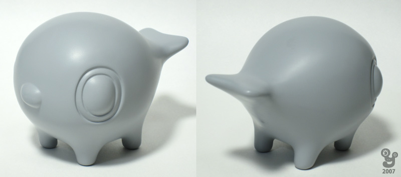

I really like this thread! It’s exciting to see your progress! There is a lot of possiblities that zbrush can applied too! I found Union Model in China last night that can make some cool plastic toys from your 3d models. Not sure how much it costs at this stage. It makes me realise there could be a need for this type of business.
Questions:

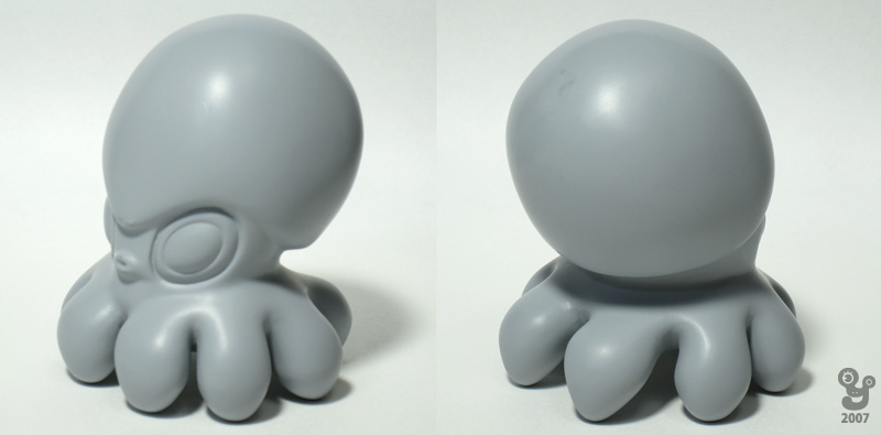

What are your toys made out of? Is it a hard and heavy??
Did you paint the surfacer on to bind the surface and fill in any air bubbles?
These would be great with transperant plastic!
Please keep posting any updates Hiroshi!!

>> Questions:
Yes, they are made from resin. They are not midair.
Sometimes Yes., but I prevent the occurrence of the bubble as much as possible. I used only primer in the process of the final reproduction.

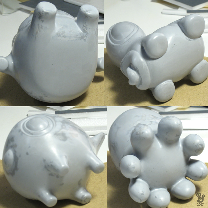

Continuation…

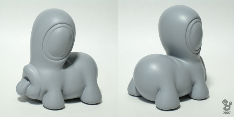

surfacer, sanding, surfacer, sanding, surfacer…
I repeated the process about 5 times.

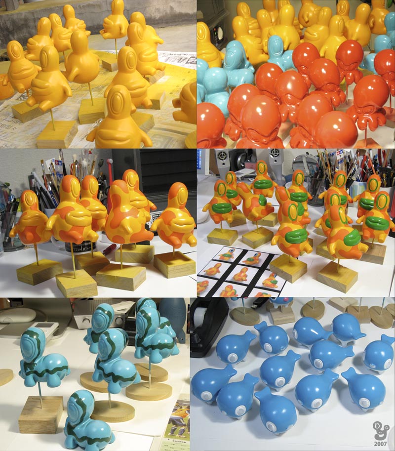

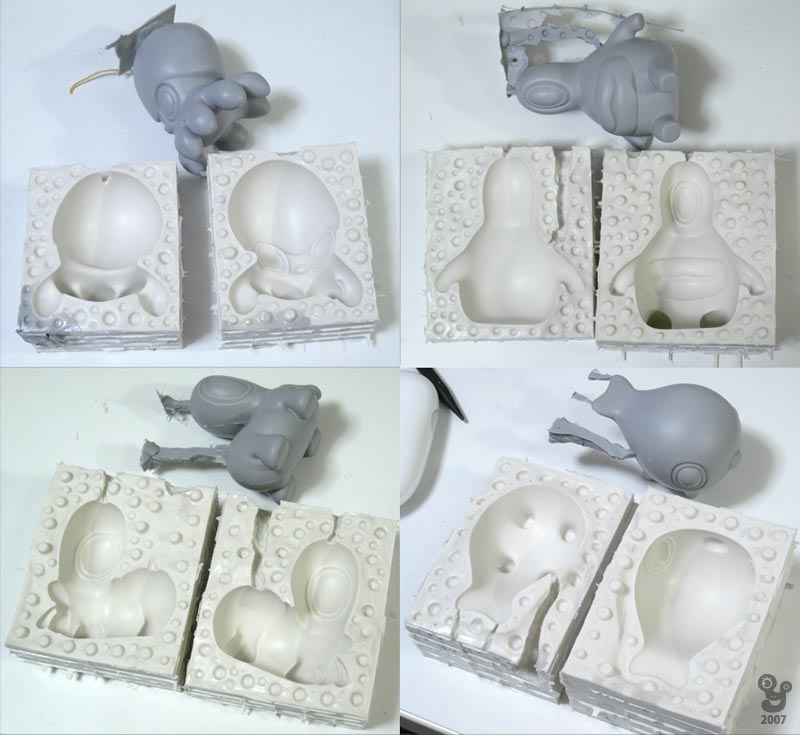

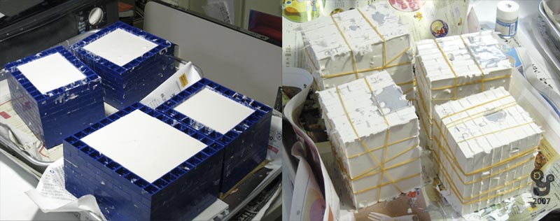

Are your mold boxes made of legos? I like them.
Also, a gentleman who knows a lot about casting suggested using stretch film to hold the two halves of a mold together. Stretch film is a plastic wrap used for packing things like this (http://www.amazon.com/gp/product/images/B000NHTUCY/sr=1-1/qid=1184335636/ref=dp_image_0/002-6338002-0873640?ie=UTF8&n=1064954&s=office-products&qid=1184335636&sr=1-1) .
