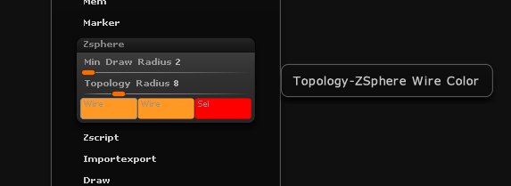

Happy happy…
[attach=65207]yes.jpg[/attach]
edit Minor evil, to activate symmetry you have to hit the activate symmetry button before you can select an axis to turn it on for. Only took me 5 min to puzzle through that. :lol:
