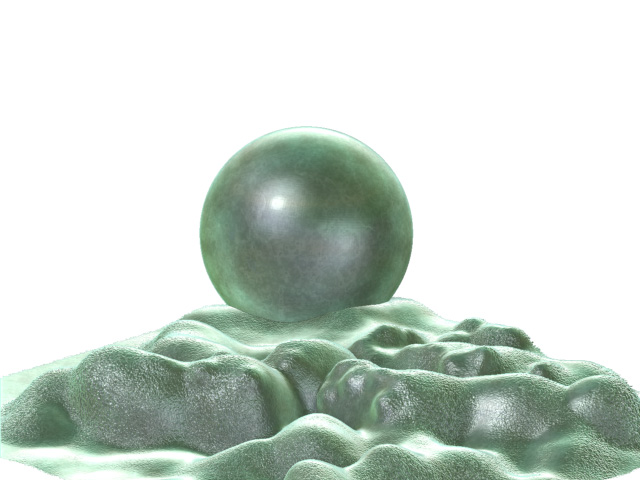

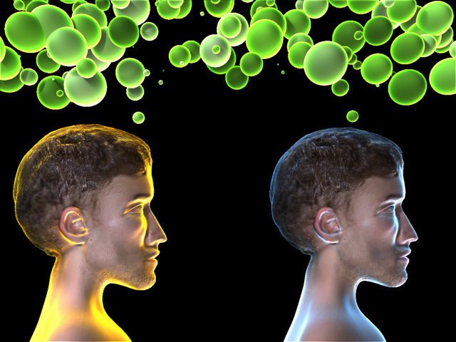

Heres one for a start:
Its a quite basic setup, but gives some funny fluorescent effect. Since it is light dependent, use it on a separate layer and bake the effect if you want to use it in a scene! You can easily change the glow color by changing the third lights color settings.
I like the green blobs! looks really fresh and may be good for illustrations. thanks!

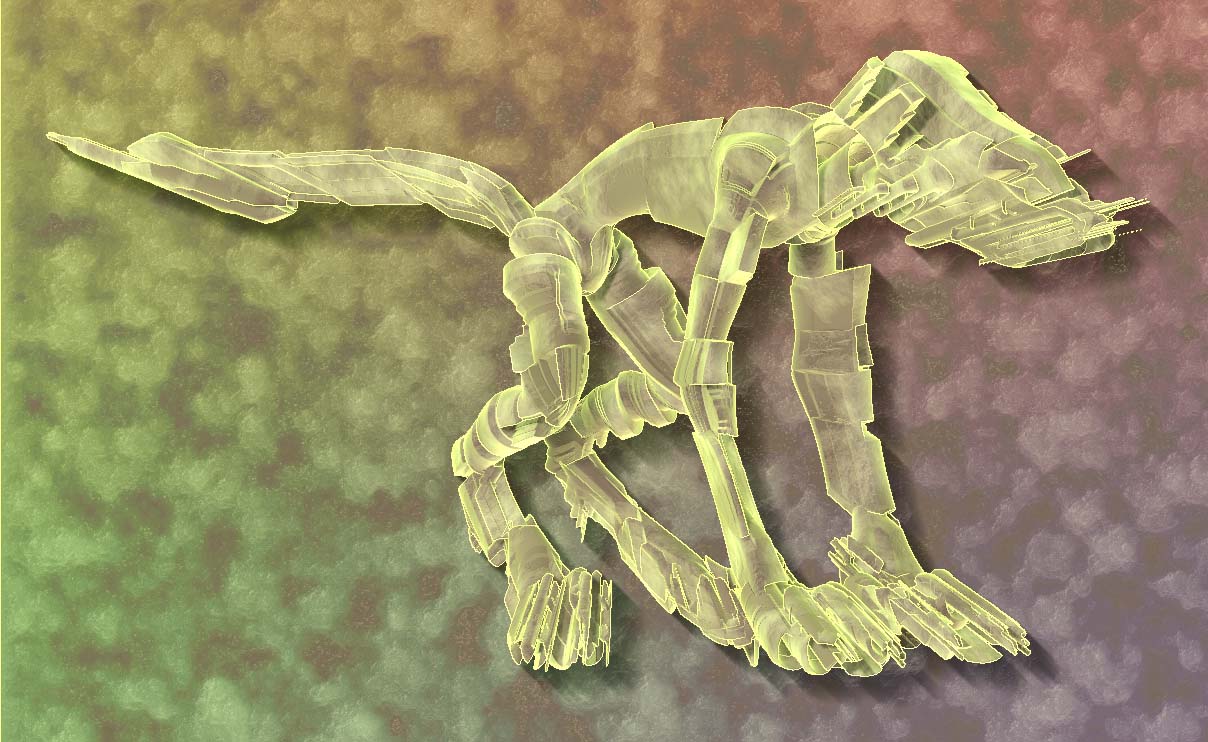

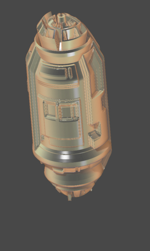

I did a rev of your fluor lights and added them onto your alien mat and got this metal foil like look. Used zb’s default texture spectrum and rendered best with shadows and depth on

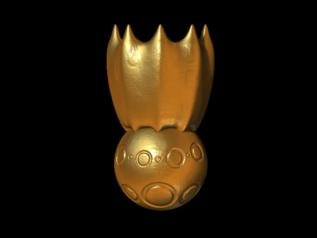

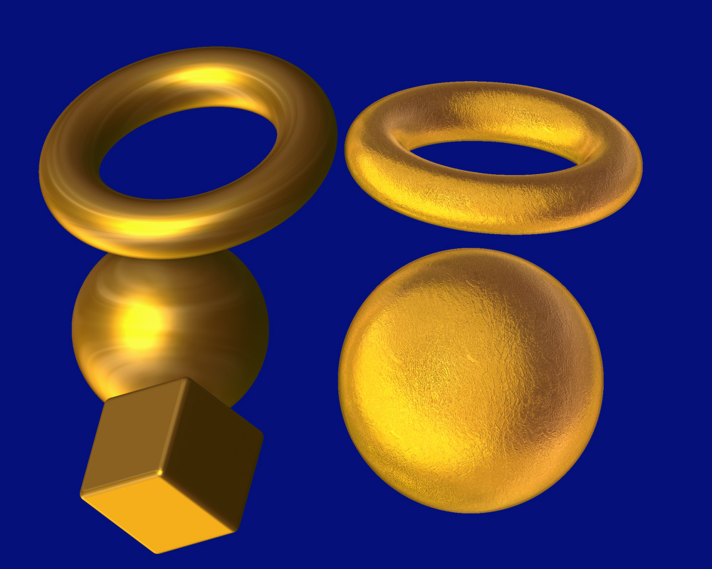

Heres another gold (posted a while ago)
PS: Spaceman, you could try to change the colors in the different shader channels.

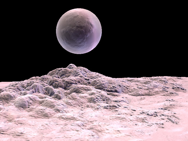

another one, can be used in space scenes or to simulate (sort of) images made by a raster-elektronen-mikroskop (whatever the english word for that may be).

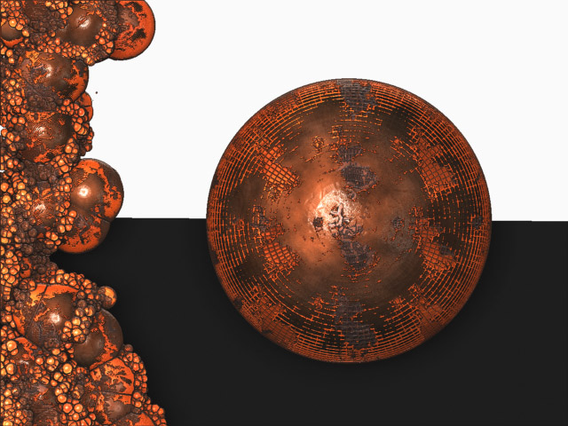

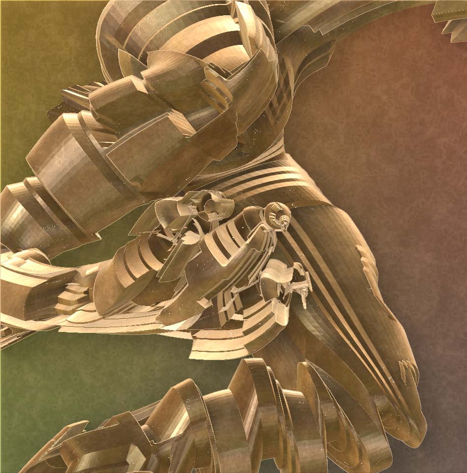

Erklaerbar thanks for the tip- reworked your mat and lights and got the bronzeee like color
Blaine91555 some really cool golds thanks
- I used your mygold to create a gold texture with grab doc and Erklaerbar’s white cs mat -
- the model is froyd’s hound ztl here at zbc (zeebled)

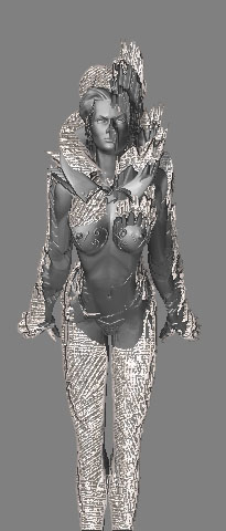

I noticed a glitch in the bronzeshader however, see these little white points? Dont ask me where theyre coming from, but i suspect its something in the Gel shading settings. I noticed them on some own materials too, can be quite a pain to get rid of them
If anyone knows more on how these glitches are created and whats the reason for it i would be very much interested to hear it.
Erklaerbar I do not know what is causing the effect of the specks.

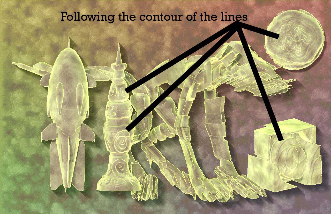

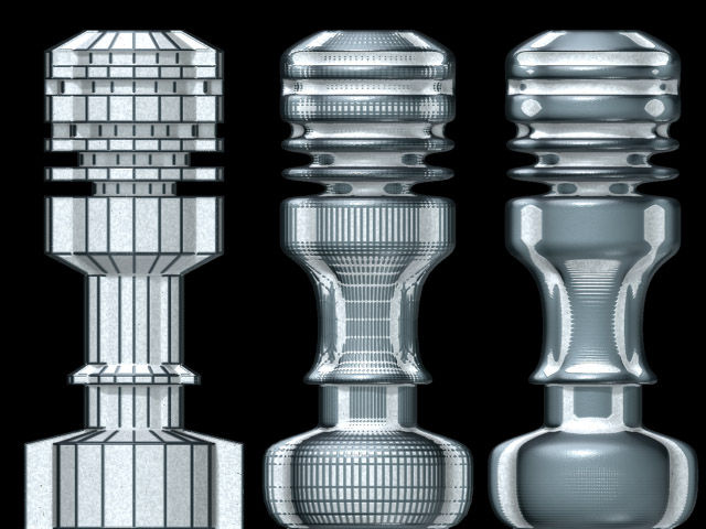

A few things that I would like to get as a mat and light set is a translucent white with gold/bronze/and/or browns AND a translucent blueish white with silver/and/or grays THAT outline the details. Erklaerbar’s nanotech mat and flrou lights come close to what I am trying to explaining and the image 1nano might help in explaining

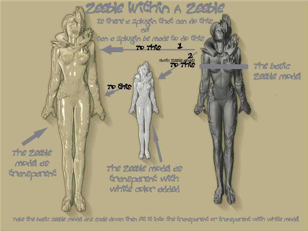

I have been thinking about this for awhile and do not know if zbrush can do it so I have included an image that might explain it better (where one of the ztools is very translucent and the other is the detail ztool)
SpaceMan - I’m not sure I understand but this mat might be helpfull. To get the effect I think you want - change the ambient and cavity colors on shader 4. As posted it is a golden color. Must be rendered on a seperate layer with flatten off in best render with shadows on. For a transparent mat just use the plastic default and set tranparensy to 100 and give it a little reflectivity.

Now the second part of the question is can/how do you place the transparent mat ztool over a soild ztool of the same model so that the transparent ztool will allow the soild ztool (same model not a different one) be seen through the transparent areas of the transparent ztool. ( some scaling of the transparent ztool might have to be done)

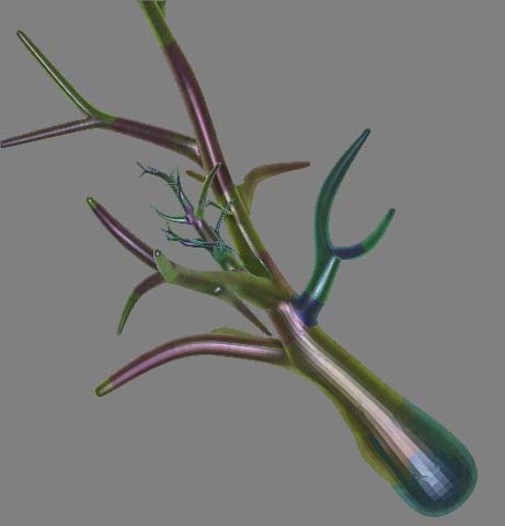

In the meantime there is another mat. Sort of dark hence the name:

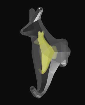

ZBrush can do this (if I understand you correctly) but you need your two objects on different layers for the transparency to work. You must also switch off Flatten in the Render options. Draw your first object on one layer and Mark it. Create a second layer, switch off the Material option in the Marker palette and all the other options on. Choose your transparent material then click on the marker and your object will be redrawn. You can then use the Gyro to scale. Do a best render to see the effect. (For some materials you may need to switch layers before they update.)

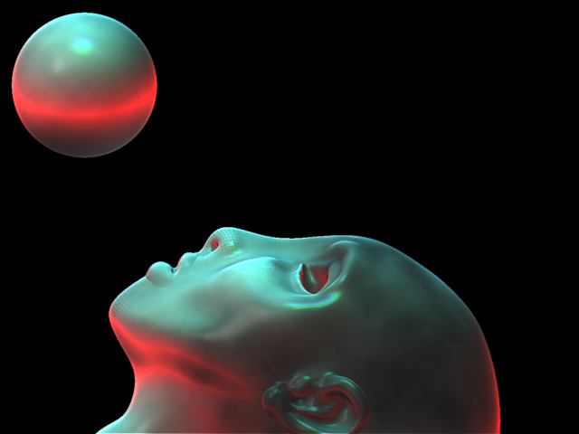

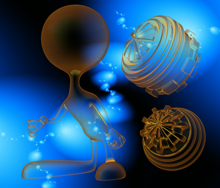

Took a break from the transparent mats and did your work flow with markers with some other mats and got a walking out the shadow effect that I guess could be done to look like walking out of liquid with other types of zmats. Just a show the effect image experiment.

Here is another mat that might be a little closer to what you need for your outer material. It’s as close to metalic gold as I can get on a transparent mat. This render is done with the default lights. Also turn flatten off and turn on shadows and best render. A good starting point for a metalic gold color is - Red = 150, Green = 80, Blue = 15.
