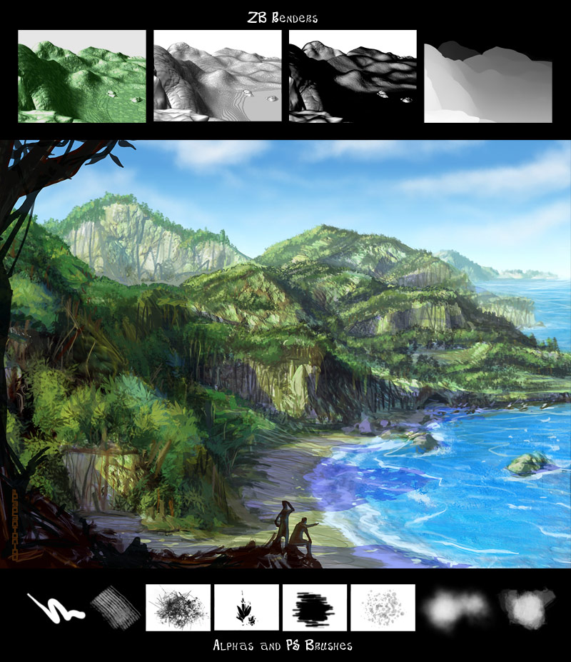

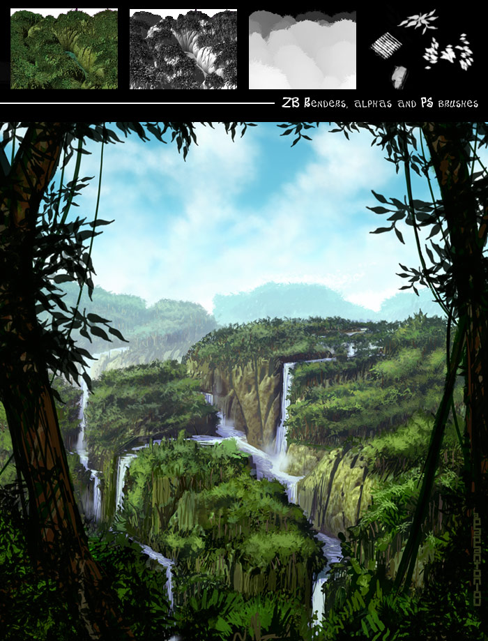

I am going to be using ZBrush in combination with Photoshop and sometimes Modo, in order to achieve the highest efficiency in my images. This is a speed ZPainting. It started as a displaced plane. I rendered it with several passes and then I composed the renders as layers in PS. Then I speed-painted some of the areas of the renders using brushes derived from drawings and ZBrush alphas. Total time: 2-3 hours (not fast enough).
[attach=49408]JungleIsland.jpg[/attach]
This is a product of the same technique. Here I tried to be bolder on my brush strokes to increase the speed. Also, I used the Fiber Brush in ZB to create a better base for the speed-painted trees. By doing that I didn’t have to paint tree trunks (except for the two in the foreground), and also I could bettera visualize the jungle.
Total Time: 1:45 (somewhat satisfied).
[attach=49409]Jungle.jpg[/attach]

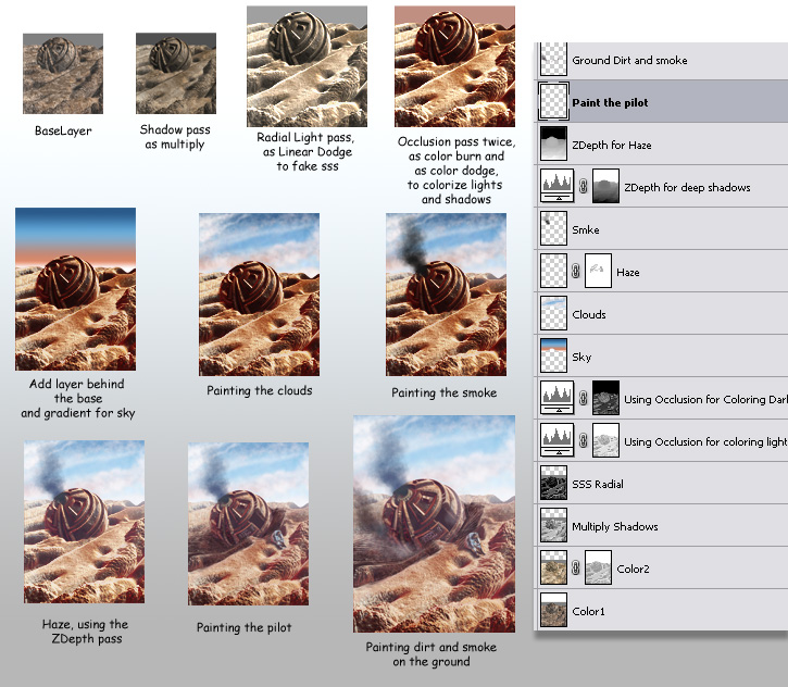

Same technique again, displacing a plane and also a sphere primitive with one of the default tecxtures in ZB. The creation of distant shots with ZB is intriguing. This went faster too. Here is my layer composition too.
Total time: 1 hour (about 15 minutes in ZB and 45 in PS).

Thanks for the breakdown of the picture elements. They give me courage

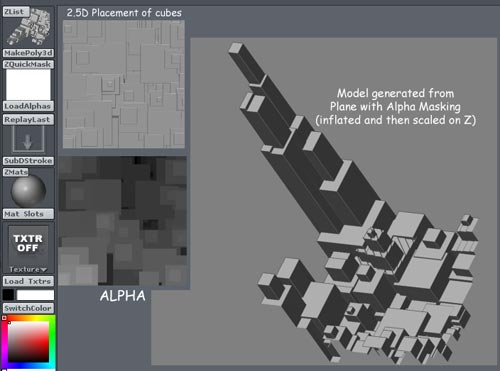

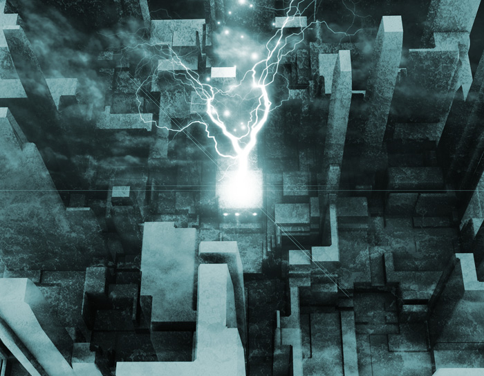

Another experiment. This time, I generated the model from a masked plain which I then converted into a Poly3D.
I also created adaptive UVs in ZB but I rendered it with Modo.
This is an occlusion rendering. Glows, colors, grunge and dirt were added in Photoshop.
Time without rendering: 20 minutes.
I rendered this at about 2500 px wide. So the rendering took another 20 minutes I think.
[[attach=49449]City.jpg[/attach]]
[[attach=49450]City2.jpg[/attach]]
[[attach=49451]BuildingsAlpha.jpg[/attach]]
This last one is rendered in ZBrush and painted in Photoshop. The lights are part Zbrush (Intensity and Glow brushes) and part Photoshop (color dodge).
SCALED ON Z!!! hahaha… Now I feel like such a retard. I always ended up with flat results and could not find a good way with size and inflate, spherical…
LOL… Have to try that today. Thanks fir the hint. It’s so obvious, but I didn’t get it…
