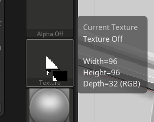

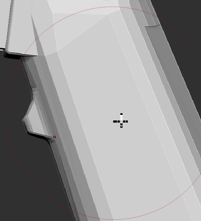

After updating to Zbrush 2020.1.3 my cursor crosshair seems to be drawing from different image files or corrupted versions of the proper image files. My only screen capture utility does not use a hot key so I’m unsure how to show you the problem. My main difficulty is that when navigating the UI, I’m unable to easily tell where the center of the cursor is and end up clicking the function above or below the intended button.
Figured out how to screenshot the cursors - upgraded to 1.4 but problem is unchanged:
Cursor1 cursor2 cursor3 cursor4 cursor5 cursor6
