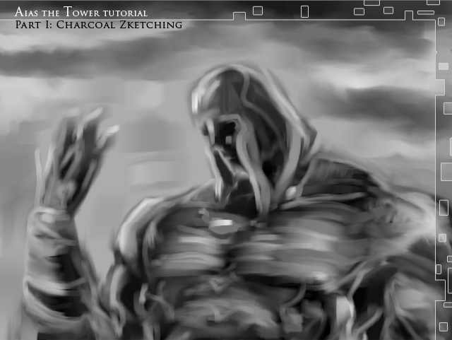

This is the sketch for my image.
[Sketching.jpg](javascript:zb_insimg(ā€˜33782’,ā€˜Sketching.jpg’,1,0))
To draw this I used a charcoal immitation technique. Check it out in the following ZScript:
Sketching.zip

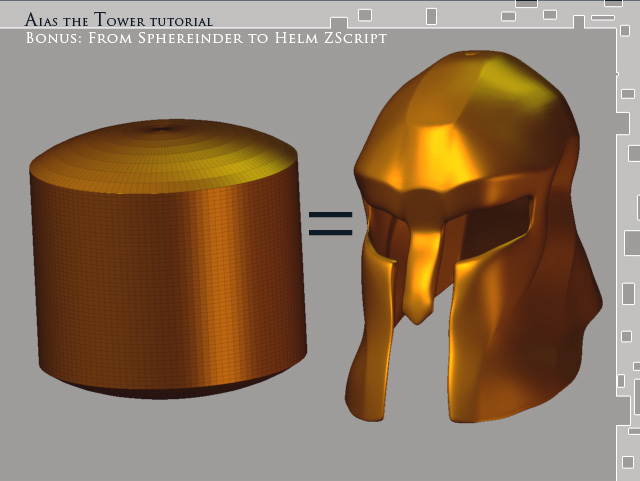

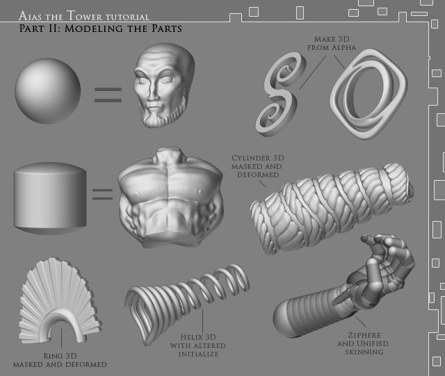

Based on my sketch, I modeled the parts I need as reference for my painting. This forum is packed with information on how those parts are created, so I will keep my walkthrough simple for this part.
[Modeling.jpg](javascript:zb_insimg(ā€˜33787’,ā€˜Helm.jpg’,1,0))
So I recorded the process in the following zscript:

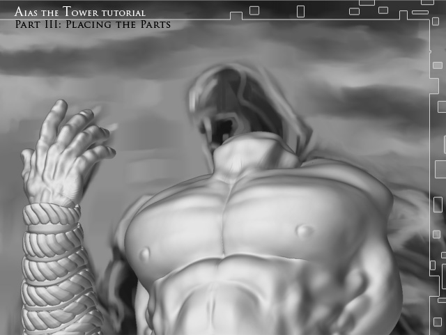

I place the objects I created on the ZBrush canvas using the Gyro tool to push them back or bring them forward. I also use the sketch as a guide for placement. Most of those objects have their own layer. If I have too many objects, I place some together into the same layer as long as their placement is not adjacent, so that I could easily edit them if need be.
[attach=33789]Placing.jpg[/attach]

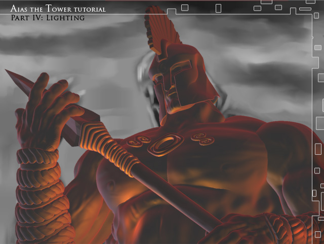

Once the objects are placed, I begin my lighting experimentations. This is a very important part of the process, because it will affect the final painting more than anything else.
I am not overly concerned about rendering as I light my image, since it will be painted. My lighting goal is to create effective reference for my painting and to bestow some emotional impact.
[[attach=33790]Lighting.jpg[/attach]]Lighting.jpg

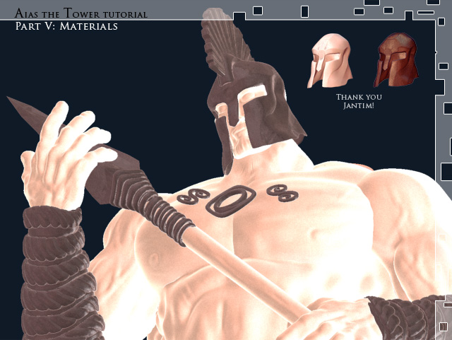

Since all of my objects are placed on separate layers, it is easy to paint them with materials. For this image I used only two materials. More variations will be created during the painting stage.
[attach=33791]Materials.jpg[/attach]

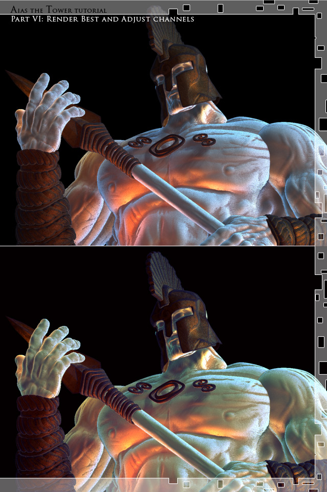

I turn on the Best render option, with shadows on. I don’t care about antialiasing at this stage, nor for size. When I use this process, I usually render at low resolution. That way I can render faster and with more rays for my shadows. I have also noticed that materials look better at lower resolutions.
After rendering I always tweek the brightnes, contrast and channels of my image with Adjustments. Some times I create several versions, and then blend them together in Photoshop. For this image though, I am using only ZBrush, thus no multi-render compositing :wink:
[attach=33792]Render.jpg[/attach]

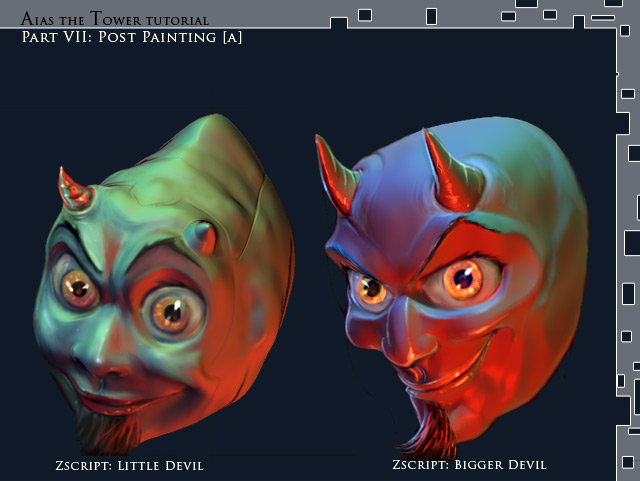

I tried to write a zscript for the process, and I ended up with two trials:
In the first trial (Little Devil), something went wrong while recording. So, the final placement of my model on the canvas was recorded with wrong coordinates. As a result, my painting is misplaced during the playback of the Zscript:mad: However, the technique is clearly shown.
In the second trial (Bigger Devil), something went wrong while recording also.
So the final rendering was not recorded correctly. As a result, the colors have shifted hues during the playback of the Zscript:evil: However, the technique and the use of the tools is very clear.
(If someone knows how to correct those Zscripts, please email me.)
In any case, this is how they looked when I painted them:
[[attach=33794]ZPainting.jpg[/attach]]ZPainting.jpg
Keep in mind that those Zscripts are recorded at a default resolution (in order for them to playback almost properly). So the brushes are not able to create the painterly texture that is possible at higher resolutions.
Check them out:
Little Devil
Bigger Devil

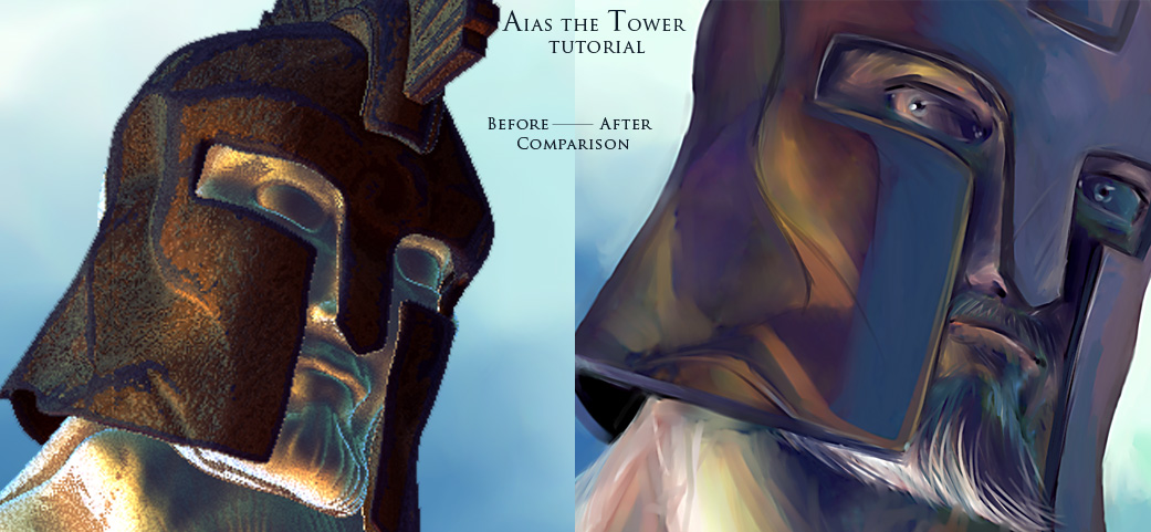

On the left you can see my low rez rendering. Of course Zbrush can render a million times netter than this. But for this technique, this is all I need.
On the right you can see the painted result, created with Zbrush’s painting tools. I had to scale this 50% down, in order to be able to upload it. The painterly texture that you see can be achieved only at higher resolutions, so that the brushes have a lot of pixels to work with.
[Comparison.jpg](javascript:zb_insimg(ā€˜33797’,ā€˜Comparison.jpg’,1,0))

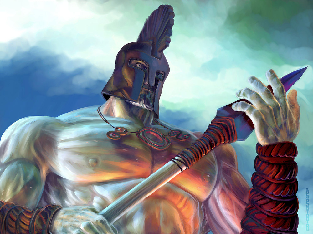

And this at last is the final painting.
I hope you enjoyed the tour. I will be glad to answer any questions;)
[AiasTower.jpg](javascript:zb_insimg(ā€˜33798’,ā€˜AiasTower.jpg’,1,0))
