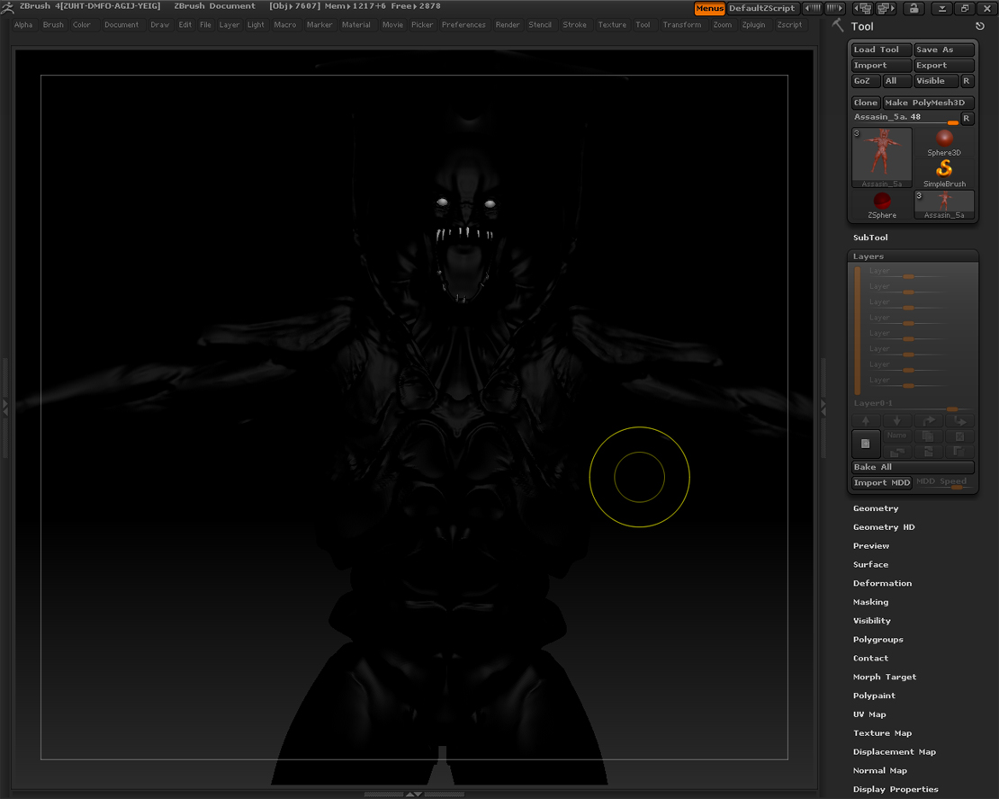

Hi guys. Using ZBrush 4 with OS XP-64, 8 gigs RAM.
I have a tool I’ve been working on for a while and am today encountering a strange glitch. If I try to do any operation such as baking in layers, usingTranspose Master, Merging subtools – the main tool turns to black.
It’s a shiny black, not a black silluohette, as though I’ve applied a shiny black material to the tool. The other subtools stay the original material (See attached jpeg).
I don’t know why this keeps happening or how to undo it.
Anyone know what I’ve done to cause this glitch and how I can undo it?
Any help would be very welcome.
T
check your material again…sometimes zbrush doesn’t want to refresh changes there.
you may need to fill the object with the flat color material to get it working again.
Hey, thanks man. That did the trick.
