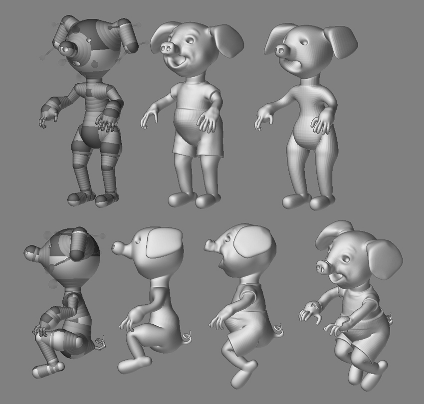

I made a piggy from ZSpheres, in lowres I started sculpting until I reached a density of 5 (Pig 1 and 2). Number 3 is set at density 4 and all the sculpting is gone (sure it was well sculpted at this level!).
Then I rotated the spheres of the legs (at density 5), also at this level the shape changed. I rotated the legs just a bit back, and all was ok.
After changing the pose of the arms the hands became realy bad.
WHY??
While the ZSpheres are visible, you need to press Tool>Morph Target>StoreMT before you begin posing the figure, texturing it, or sculpting the preview. This tells ZBrush to use the skin calculated from the default pose every time you preview the mesh, rather than calculating a new skin each time.
Thanks Aurick, I will try it
Works great!! :+1: :+1:
