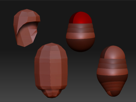

I have been playing with zsphere’s recently, and every time I make a base mesh with them, I preview it, and it looks like the mesh is sort of folding back on itself towards the first zsphere that i made, what can i do to fix this?

i don’t really understand what you’re saying, sorry
better?
](javascript:zb_insimg(‘156745’,‘zsphereQuestion.jpg’,1,0))
sorry,
see the mesh on the bottom?
where the bottom and original zsphere come togatherm they sort of fold over in a flap, sorta, that’s what I’m asking about fixing,

tool>adaptive skin> try turning on MC or MP also adjusting the membrane curvature I think it’s called.
Also, Zspheres aren’t meant to be the end all, just the place to get “clay” down and then edited using the traditional tools
