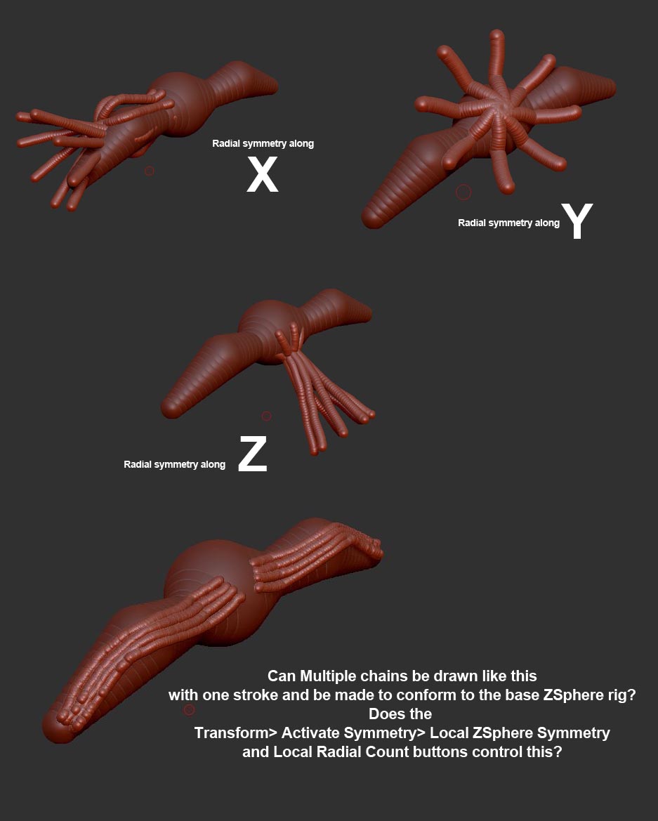

Hi! What do the Transform> Activate Symmetry> Local ZSphere Symmetry and Local Radial Count buttons do? And how do I use them with the new ZSpheres or ZSketch feature?
Turning them on doesn’t make any difference to the way ZSpheres are drawn.
Also, is there any way I can draw multiple rows of Zketch lines on my base ZSphere rig instead of single chains. Radial symmetry is restricted to the x, y z perpendicular directions. I want the rows to conform to the base ZSpheres. Something like the clumsy example at the bottom of the attached image.

thanks for the video Spaceboy. The radial symmetry can easily place points on a mesh that is at right angles or perpendicular along X, Y and Z. Kinda removes the laborious loop making steps. To that extent they are useful. i wish, in addition to that, we could just drag those points radially along geometry that could be pointing in any direction.
Anyways, so I guess the buttons are for retopology after all.
