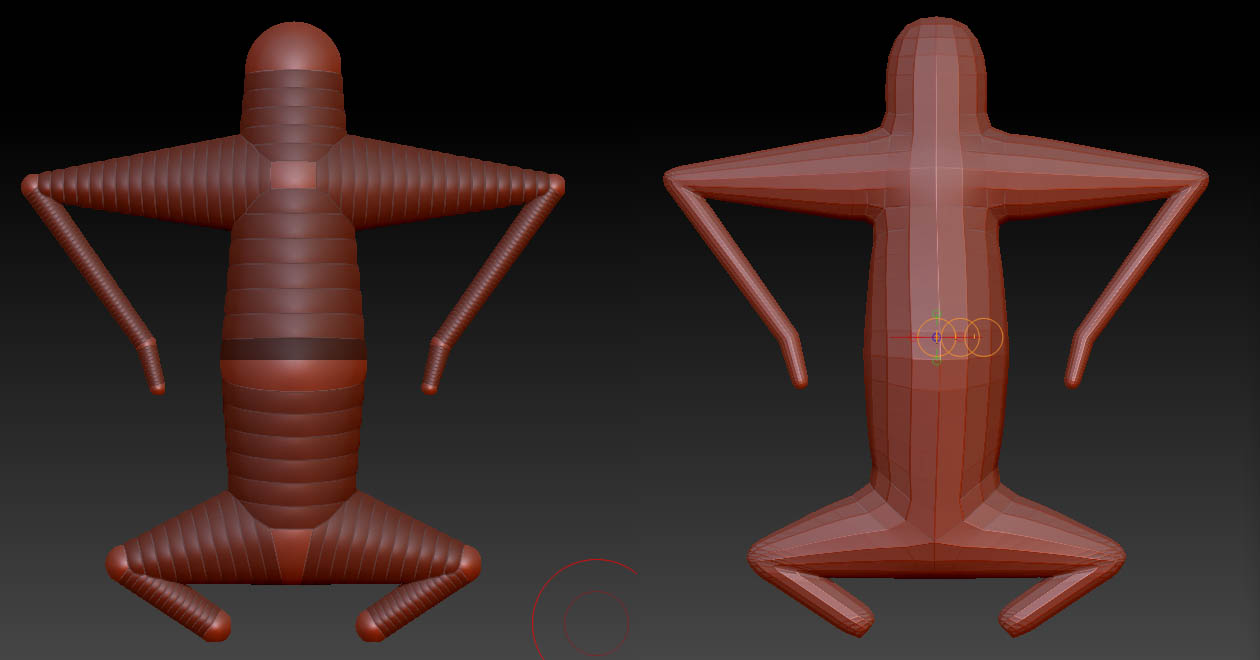

I’m learning how to model with Zspheres. Its pretty straight forward - so far. But I have this piece that Im working on that appears to twist.
When I preview the skinning, the topology for some reason is not flowing symmetrically. I tried to rotate the spheres to align the polygon flowing, but it doe not seem to work. Is there a way to zero out or reset the rotation of a zspere?
Or should I not worry about it and re-topologize this later on?
Here is the preview of the skinning:
What happens if you try moving the legs higher up the hips?
ZSpheres are actually treated much more like cubes. It’s usually not a good idea to have two children coming off the same side of the parent, which is what you have going into the legs.
Thanks, I moved things around a bit and it seems ok now, but its not what I want as far as the shape goes.
I tried adding two “eyes” at shoulder level, and it was symmetrical.
So I think I might play some more.
Here is the change:
