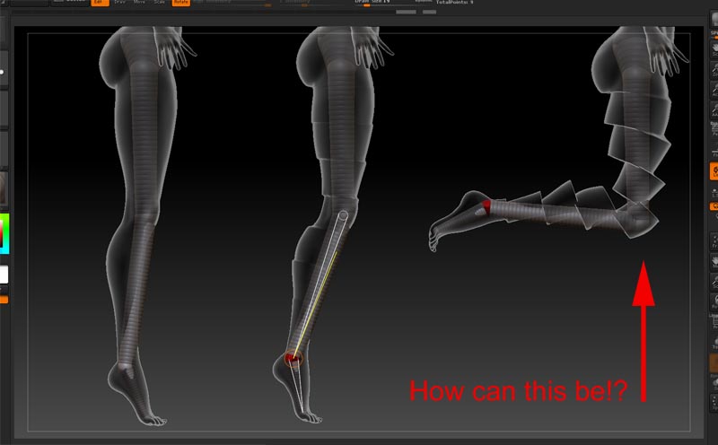

I am doing a simple Transpose>TposeMesh then selecting a Zsphere from the tool palette. I then go under “Rigging” and select my newly made TposeMesh character and make a simple rig to deform the character.
I have done this method before and even tested it on another premade character from lightbox “SuperAverageMan” & “Nickz_humanMale” with no problems…
Anyone else experienced this?
your mesh is too dense for Zsphere rigging.
use Zremesher and subD levels to lower your polycount and try again.
Did a quick test and it worked. Thanks very much!
Actually now that I think about it… That means I need to duplicate all subtools, Zremesh them to a low poly state, then subdivide them back up and re-project the details from the dynamesh sculpt, then set them to “All Low” and run Transpose Master and rig them?
Not necessarily. It depends on if those subtools have a high number of polys at the lowest resolution. You also don’t need to use ZSphere Rigging with Transpose Master - using masking and the Transpose Line works better for high resolution combined meshes. So it depends a bit on what your aims are and how much time you want to spend. Whatever you decide you’ll be able to adapt your workflow for future projects. :slight_smile:
Thanks Marcus, I’ve worked with masking/transpose tool as well and like you said it’s does work. I thought the zsphere rig might work just as well but looks like a bit of prep work is needed.
