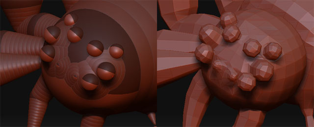

i am trying to create spider eyes but whatever i try they mix together in the adaptive skin. does anybody have any hints
here is an image to show my problem:
thanks for any help,
ello
ello

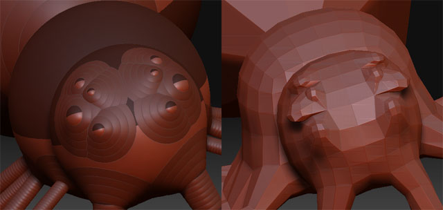

i came a little forward with it, by adding another zsphere to each :
](javascript:zb_insimg(‘110779’,‘zspspider_2.jpg’,1,0))
maybe i should try moving them in and add subtools for the eyes themself
Your picture show that you dont move the Zspheres completly in! They are only smaller.
Make a hole with moving zspheres in (from the side you see it better) and then use a sphere3D for a eyeball.
