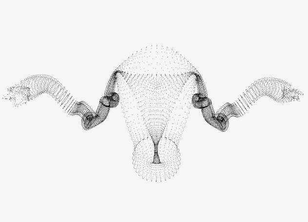

I used to compose anatomical structures. The plastic flow can be achieved amazingly punctual by the Zspheres all right. But, to show the inner anatomy of the objects in question, I manipulate spheres inside the primary ones, as though filling the cavity. Thus the result comprises both the skin and the inner contents. The whole formation can be visualized either within Zbrush, if you mirror the 3D mesh within the Tool palette or you might prefer, like me, to Flip normals.

In difference to other 3D artists, I apply the plunging Zspheres not only to compose excavations but the canals and cavities.
For instance have a look at the image of the uterus I built mainly in Zbrush: the cavity and the cervical canal also shown (A).
To perform such, one should insert the zsphere branch inside the outer branch.
Only, if the zphere goes too deep inside the outer one, the opening closes and the resulting mesh may become like shown in (B).
That is all right in terms of anatomy at a glance. But it happens so, that, in difference to the outer- from outer linkage (branch) the mesh makes a crossroad! I.e. the plunging Zsphere sends the mesh to the other side of the canal Ā©. This drawback can prevent to normally deform this part of the mesh afterwards. C shows beautifully the bug when one zsphere enters another.
I have tried a lotta means, all plugging of yours too, with intent to rotate the mesh, but all in vain! It would be great if one could control the behavior of the Zsphere in this regard!
I definitely hope the next addition of Zbrush might cope with this worry or obviate it with the new rig. In the meantime you may find some resolution earlier.
Also, it woud be great if the Zspheres could be able to connect entirely, in a way of a circle, suggested, artificially, in (D). The whole structure may then be planned in Zballs!

Yes, I have to combine meshes, produced by separate zbrush organizations.
But when the inner part is too complex, with canals and cavities occupying 3D
space on various levels, one has trouble to fit them properly inside the outer skin.
Whereas, when the Zbrush formation is all in one, the inner primary part holds on like it should.
That is why I so much crave for ability to entirely connect the sphere link (branch). No plug is capable thereof.
I understand my desire to compose the transparent forms my be out of the common plans of the 3D guys. Nevertheless, no other program can do the dotted uterus.jpg complex work I have described above, but Zbrush.

It is not possible to connect Zspheres so that you can connect a complete circle although you can assign 2 or more zspheres to occupy the same location and give the illusion that they are connected together.
As aminuts as mentioned my Zif Click script would allow you to make the inner and outer structures separately and then you could copy and paste that inner structure inside the outer structure. It also has tools that allow you to precisely move, size, rotate and set the resolution of individual zspheres or whole branches of zspheres as well as copying and pasteing zspheres together. Perhaps it can help you out in your endevour.
