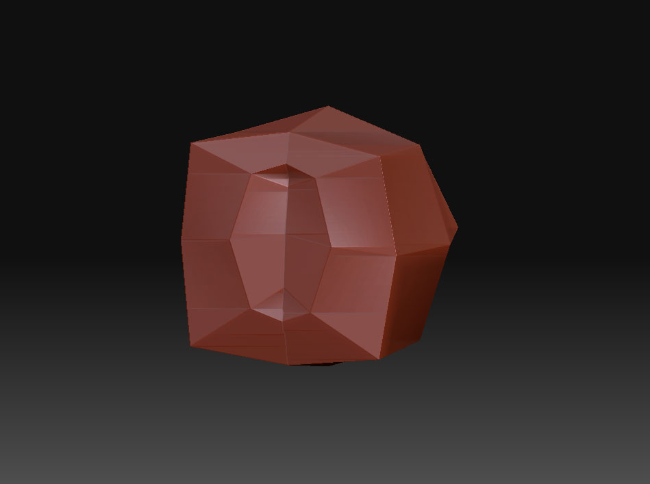

When I try to make an Zsphere inlet,my mesh becomes distorted. Is this a setting that I have to adjust? What can I do to fix this?
Simply reduce the Ires setting in the Tool>Adaptive Skin menu. This happens because you’re trying to add multiple children to the same side of the ZSphere. Any time you do that, you’ll need to lower the Ires setting.
Whew. Thanks for the help. That worked. I must have accidentally moved the slider when I was messing with the controls for an earlier project.

Another thing is that I can’t see an extra zsphere out back to help control the initial zsphere (it’s wonky at best). Also did you try moving the 2 zspheres you did add to the large master a little to see if they would separate?
