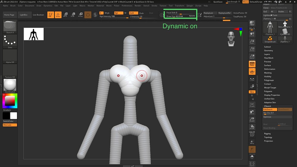

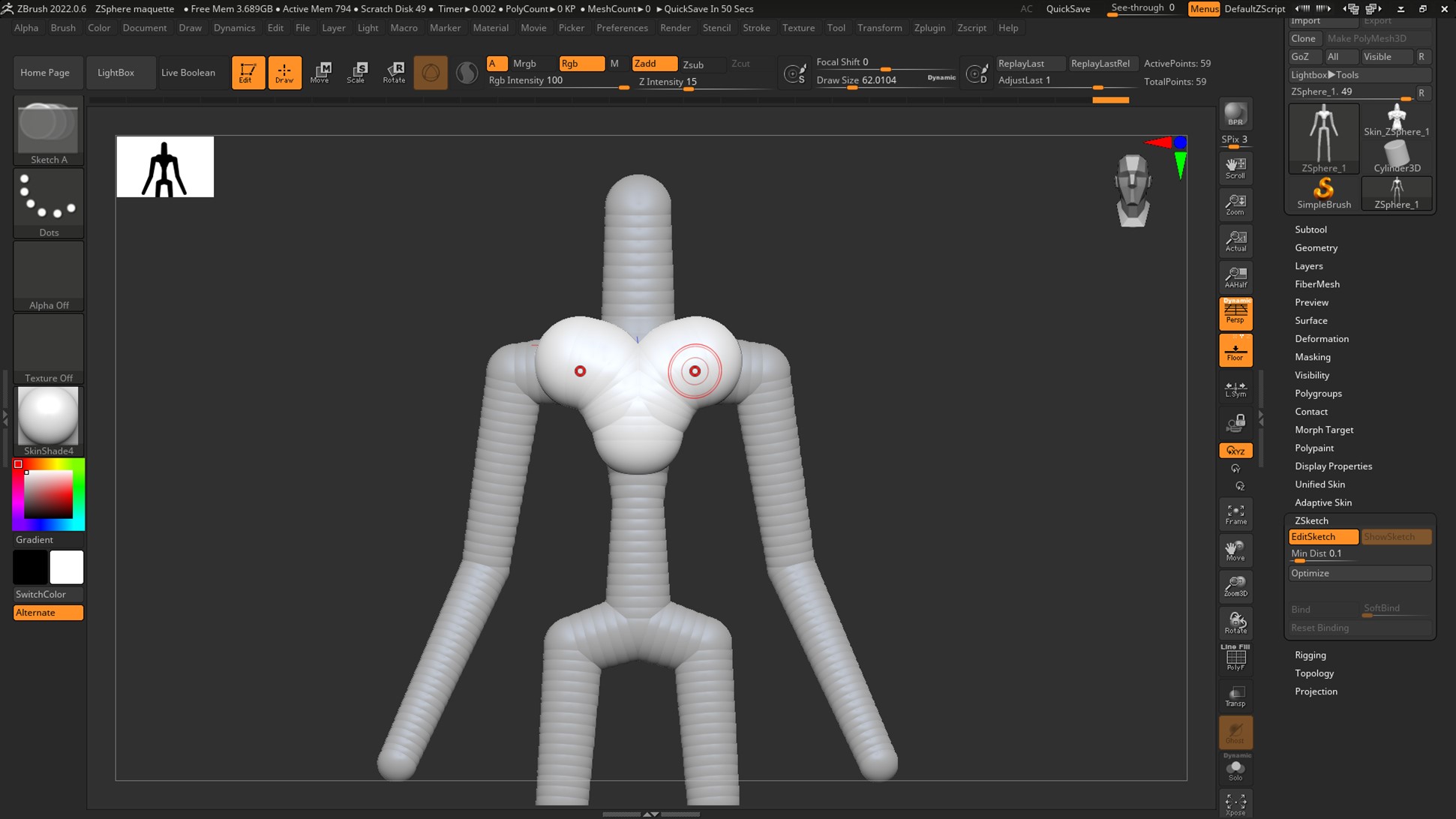

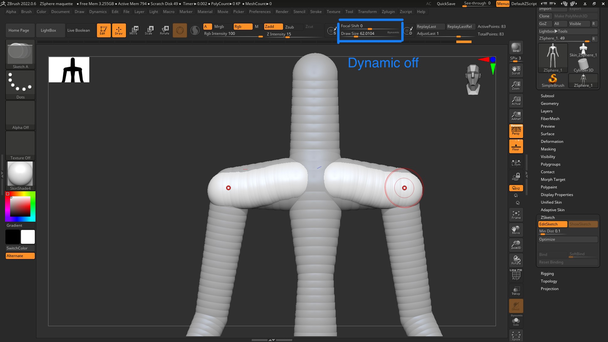

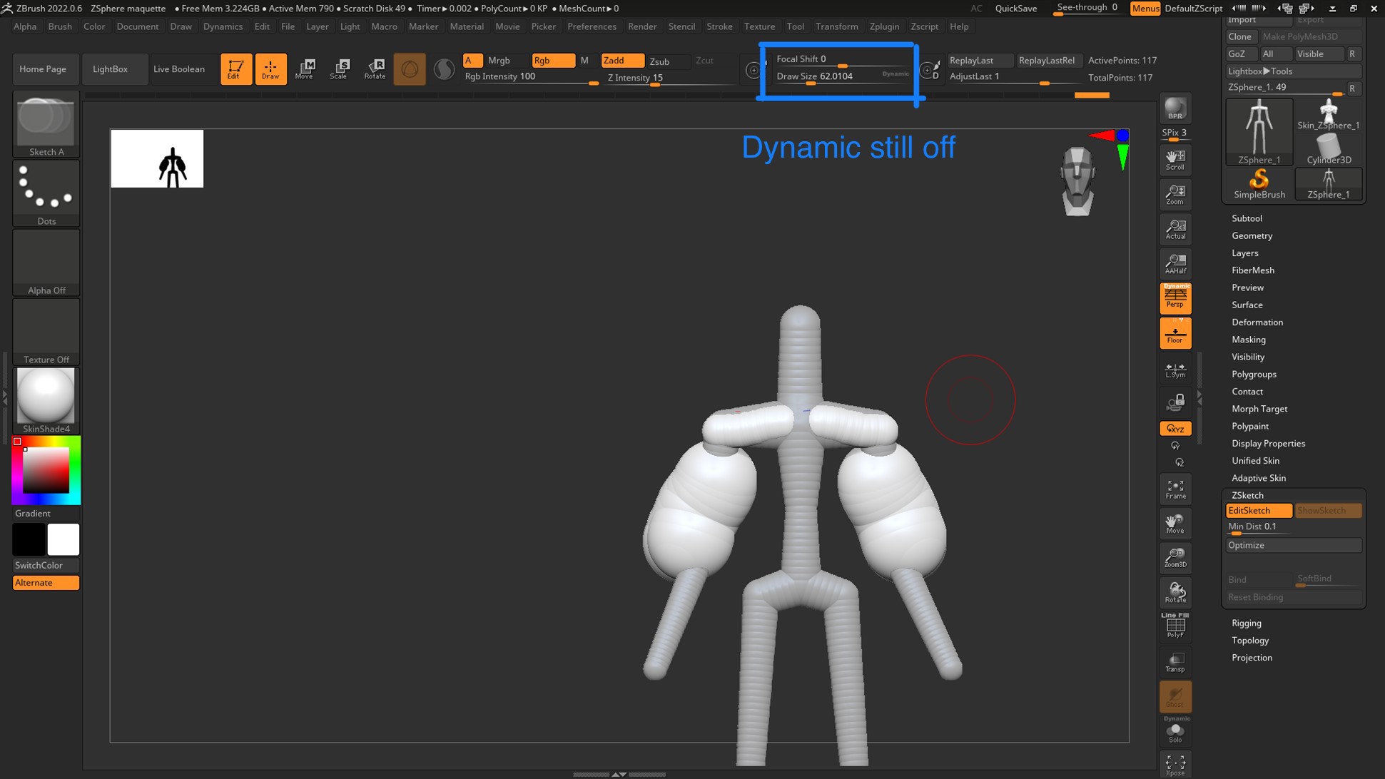

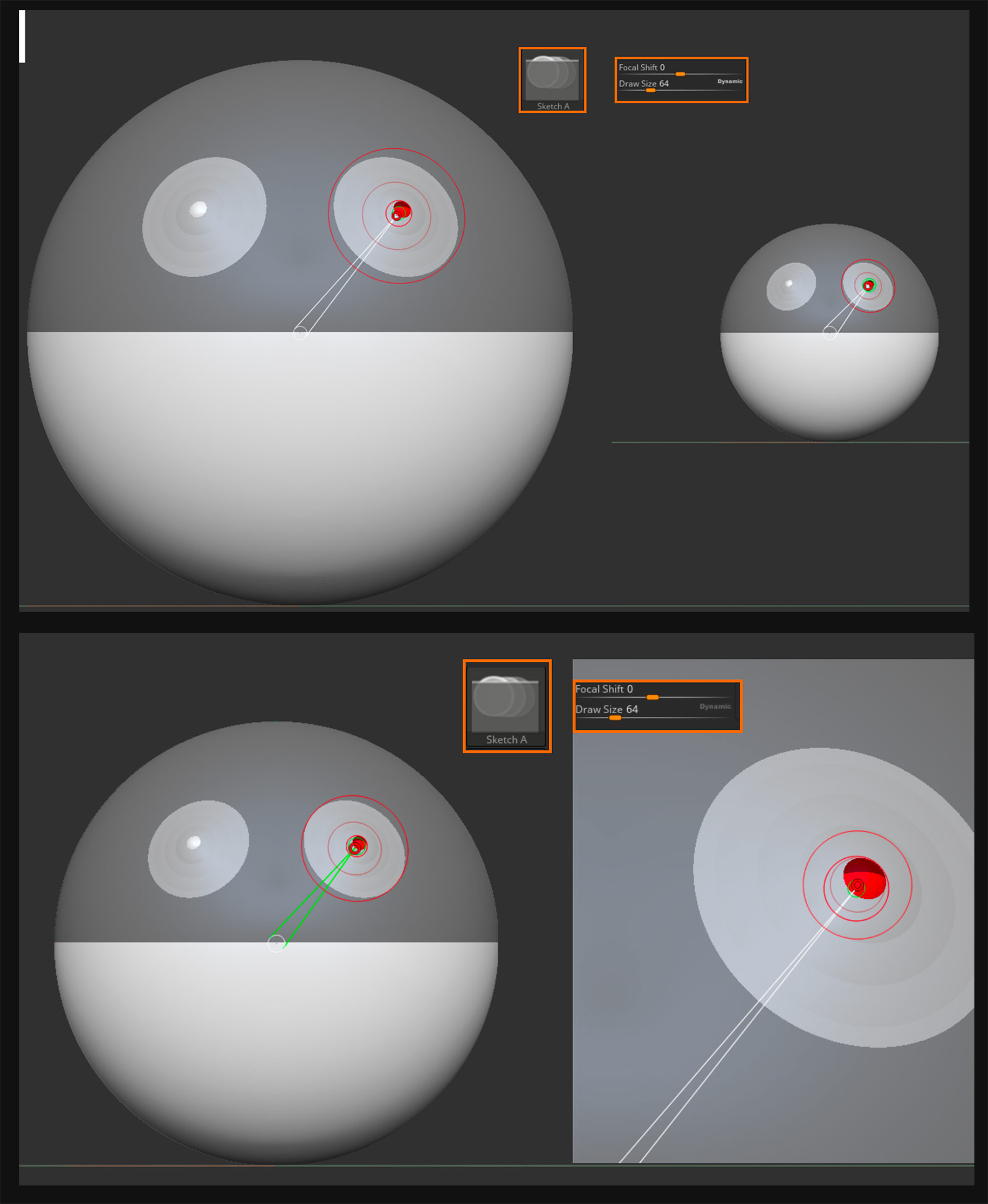

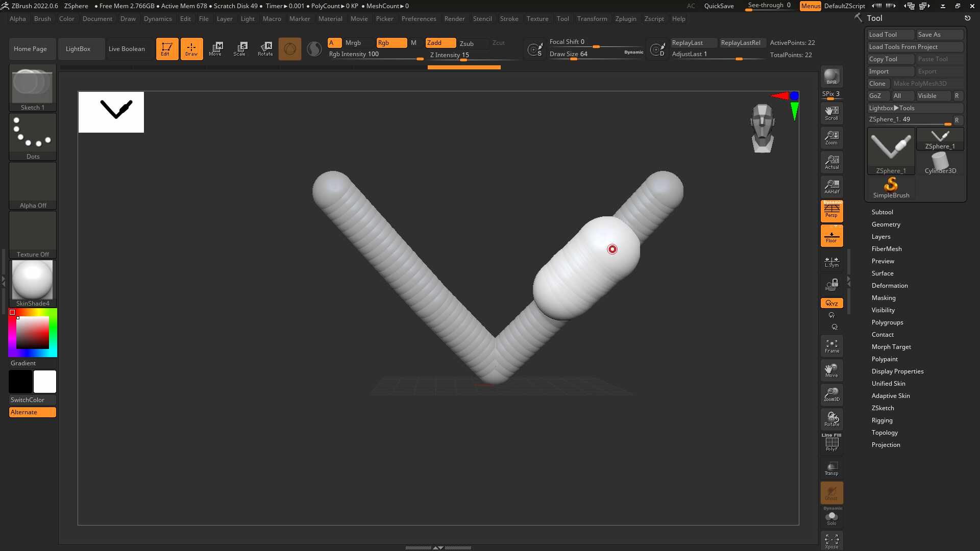

I realise that I have not explained the problem fully. All the zsketch marks in the screenshots were made without changing the draw size. In the first two screenshots, I had dynamic enabled but the zsketches produced are different sizes. In the second two screenshots, I have disabled dynamic and drawn new zsketch marks onto the zsphere armature. In both cases I drew the smaller zsketches and then zoomed out and drew the ones that are appearing larger.
It seems to be that Zbrush is behaving as if dynamic is disabled even when it is enabled. I have restarted Zbrush and the computer but the issue is still occurring. I am wondering if there is another setting or control that could be causing this or if it is a bug of some kind?

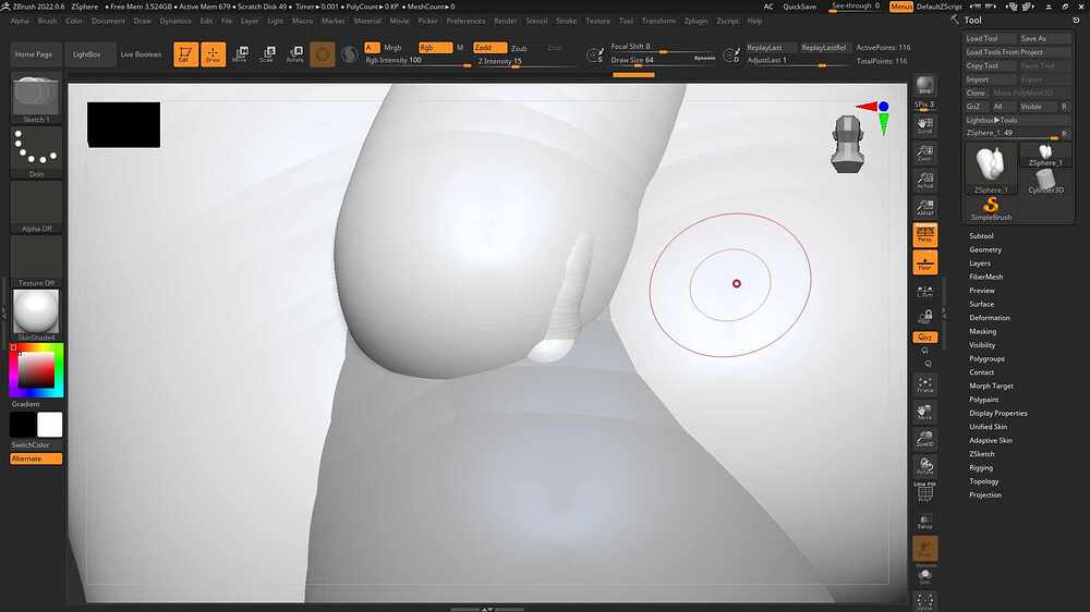

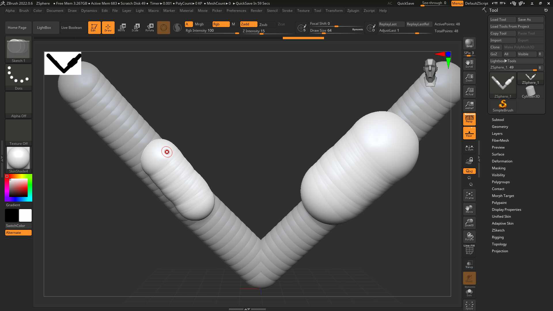

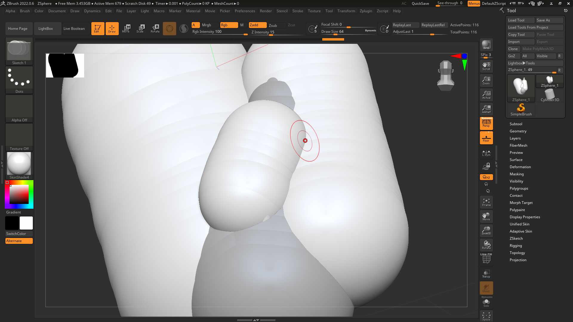

These are some more screenshots:

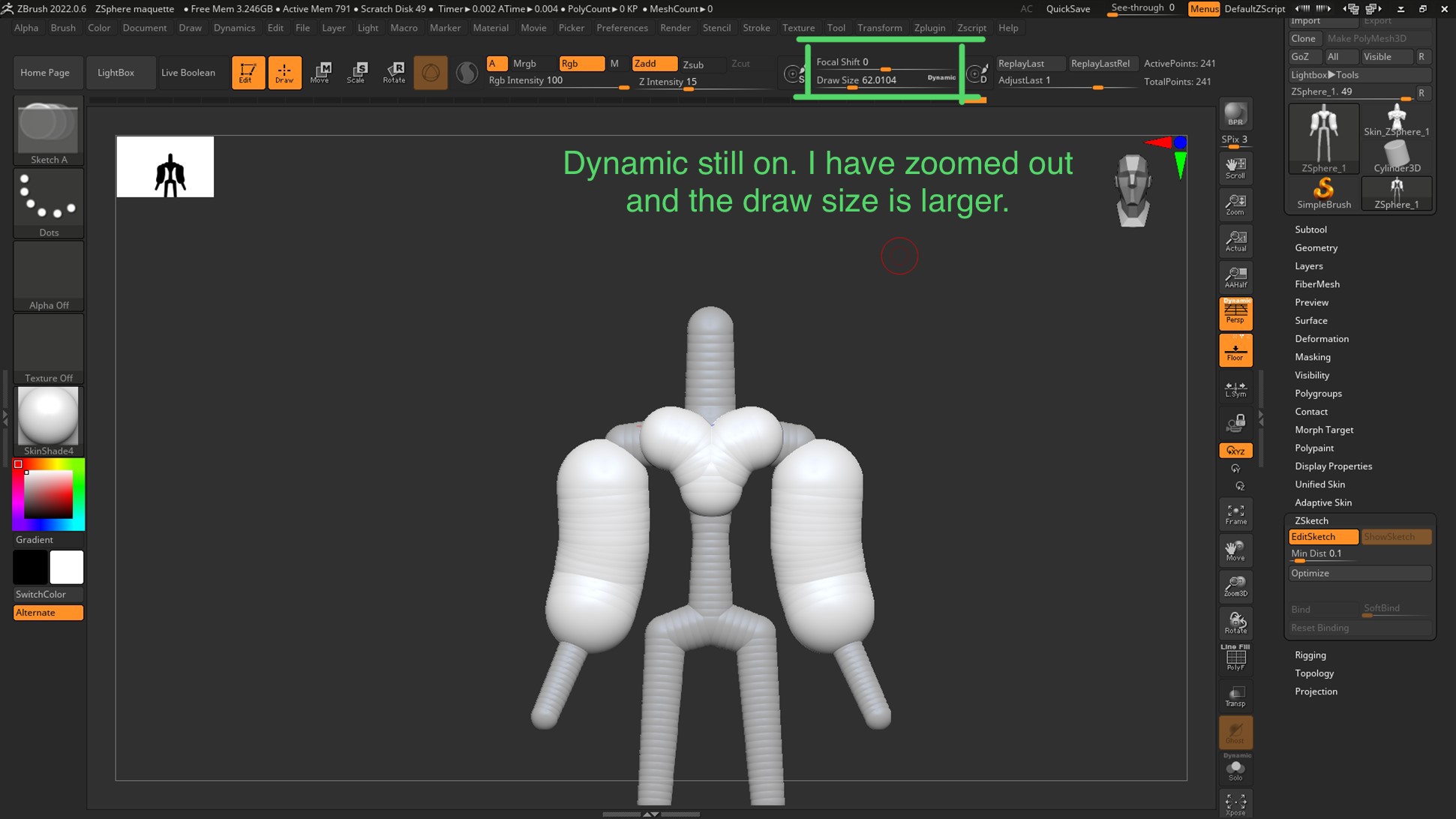

The draw size is set to 64 and Dynamic is enabled. The zsketch on the right was drawn and then I zoomed in and drew the zsketch on the left. I did not adjust draw size, intensity or focal shift. I did not vary the pressure, either. In fact, the zsketch brushes do not seem to be responding to pressure at all. The two zsketch strokes are different sizes. Based on the Classroom tutorial and your screenshots and descriptions, this does not seem to be the intended functionality.
Also, unlike in your screenshots, my cursor does not reflect the size of the zsketches and is much smaller.
There is something else that I have noticed which may be related:
When I zoom out, the smaller zsketch disappears inside of the larger ones. This did not happen in the Classroom tutorial.
The issue could be with my Wacom. However, all other draw functions work and the drivers are updated, so this seems unlikely. I have also tested by restarting the computer with the Wacom unplugged and using the mouse to draw zsketches. The issue is still present.
I have seen a similar problem discussed before but the solution was always to enable Dynamic. Of course, in my case, Dynamic is already enabled.
