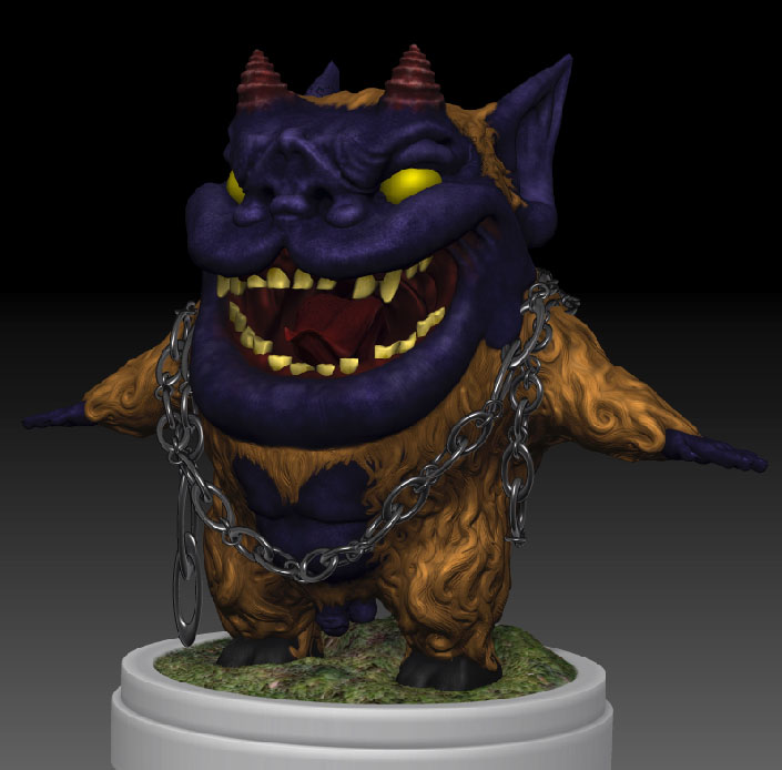

Thank you so much for that script- it works beautifully. I hammered out the below (admittedly sloppy) chain in about 3 minutes from ZSphere creation to end. The script is a huge time saver.
Best,
