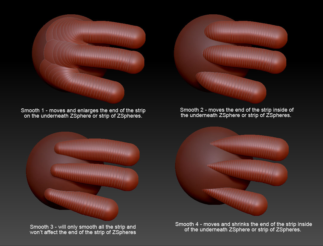

Here’s how it should work…
Smooth 1: moves and resizes the stroke.
Smooth 2: moves the stroke but does not resize.
Smooth 3: resizes the stroke but does not move.
And here’s how it currently works:
Smooth 2: moves and resizes the stroke.
Smooth 3: moves and resizes the stroke.

Note that it is the attached end of the strip that is affected. This is how they work for me:
marcus i just tried it again and now it works, i think my mistake was trying the ends not the starting points as you did in your example. wasn’t there a way in 3.5r2 to have the ends taper off though?
If you want to taper the unconnected end simply use the Bulge brush with Alt pressed.

One thing that could vary the results is the direction of the sketch stroke. Try the other end of the sketch stroke and see if you get the results you want. If so, then you just have to change your direction.
