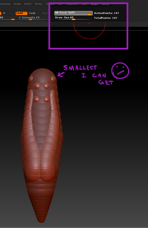

Im not sure if anyone can answer this, or if this is just normal, but when i have the focal shift as small as it can go, the smallest step i can get from a stroke using zsketch is still quite large.
The image below better illustrates what i’m talking about. The strange thing, is it isn’t a problem with the wacom driver or anything, i use photoshop all the time and the pressure works like a charm in there, but the second i go to zsketch, i dont feel like i’m getting a full ramp up from smallest to largest, it’s as if it starts at about 30% up from where it should. Any ideas as to what could be the problem, or what might fix this?
The Focal Shift doesn’t affect the size of a drawn stroke in ZSketch. The Draw Size does, and if you set that to a smaller value your drawn strokes will be smaller. However, you might also like to try setting the Preferences>Tablet>Size Sensitivity slider to the maximum of 1. The default is .75 and setting to 1 will give greater variation in the strokes. You can save the setting by pressing Shift+Ctrl+i.
You are a lifesaver! that thing with the tablet preferences totally fixed the problem and did exactly what i want. Thanks very much!
