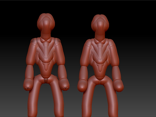

So, usually that works beautifully. However, sometimes I have this issue (This is a sketch my roommate did, I’m troubleshooting the issue because I’m more tech inclined) :
http://i.imgur.com/JSLkX.png
<img src=“http://www.zbrushcentral.com/pixo/atn.gif”>
This is what the ZSketch looks like:
http://i.imgur.com/wQmYn.png
As you can see, the mesh in preview mode doesn’t support any of the ZSketch that was placed on the mesh. I can’t figure this out. Usually, I just say screw it and start again, but I would really like to know how to make it not do this in the future. I looked through the settings, everything appears to be default, I don’t think I clicked anything, but something probably changed that I’m not seeing.
Solution?
With Z sketch you aren’t making an adaptive skin, you are making a UNIFIED skin. So go into the unified subpalette and play with the resolution and smoothness and press “make unified skin” to get your desired results.
Left: Zsketch model Right: Unified skin
