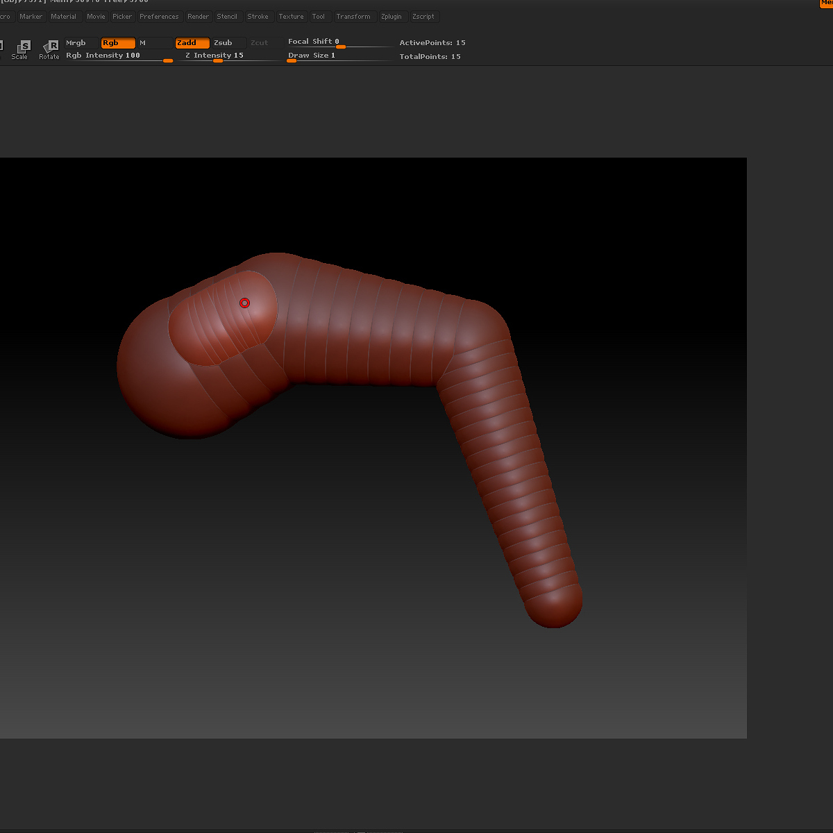

I am having trouble using Zsketch in Zbrush 4r2. No matter how small I set the draw size or how large for that matter, the zsketch creates the same size spheres…I have tried shutting Zbrush down and relaunching it, but the same thing. Is anyone aware of a fix for this? Is this happening to anyone else?

My system is using Vista 64 with 4 Intel Xeon 3.00 Ghz processors and 24 gigs of ram.
The screenshot shows the brushsize set to 1 and yet the zsketch spheres are much larger than a size 1.
Hopefully this will help.

There is a slight startup draw size issue in 4R2 which you can get around quite easily. If all you do is start ZBrush, draw a primative and start sculpting right away, you don’t have to worry about this issue. Otherwise…
If you have just started ZBrush 4R2, draw a Sphere3D on the canvas, turn on ‘Edit’ (T), turn off ‘Edit’ and then ‘Cntr+N’ to clear the canvas. Now your all set. If you already have the ZSphere chain started and are editing it, all you have to do is, while still in ‘Edit’ mode, click on the Sphere3D in the Tool palette to put it on the canvas and then re-select the ZSphere tool you were working on. Now draw size will work and remain working until you close ZBrush.

Thanks for your help. That worked fine. I appreciate it.
