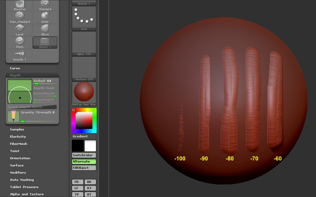

zsketch depth buggy in R6
I made these two videos with R2 and R6p2.
In R2 the depth works as expected.
In R6p2 depth appears to not work for negative values.
Both videos had depth set to -100
First R2, where it works as intended:

Then R6p2 where it is broken:
//youtu.be/vg3DW8yP4pM

I tried R5, same problem. Then R4 and it worked as it should. So it seems something changed between R4 and R5. I’ll try some different drivers here, just in case.

I have noticed that at negative values, the depth is altered, but only such that at -100 depth, the zsketch spheres go exactly half way into the surface.
Ok, minor breakthrough! Disregard the last post. Apparently how deep the brush embeds is dependent on how large the zsphere was drawn at, put into edit mode and begun zsketching on.
If I draw a small zsphere to begin with, press T and then shift-A, I get fat tubes of zsketch on top, even at -100. But if I draw a much larger zsphere, press T and shift-A, I can get depth of -100 to look the way it should. If I make it TOO big, even values of -90 or -80 will not show, because the zsketch is embedded too far inside.
The crazy thing is, once the depth works properly, I can start a new document with a new zsphere, even a small one, and the depth works properly still. No fat tubes or deep embeds.
If I restart the application, however, I will have to “calibrate” it again, by doing too small, too big and just the right size zsphere.

I might have spoken too soon, because even if the afore mentioned “hack” works, right now another effect has manifested: strokes that start out accurate increase in size as the brush moves away from the origin point of the brush stroke and then decrease in size if moved back towards the origin point.
Could even do some fancy effects like this, entirely unintended and buggy, but interesting :slight_smile:
I just did an initialize of zbrush, and now the strokes work as they should. The effect gone. All dandy. Until restarting the application of course.
