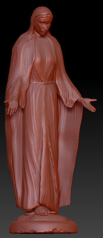

This is my first project with ZBrush, so please forgive me if this is a “noob” question. I’ve created this model, and am trying to use the ZRemesher to lower the poly count, but it keeps telling me there is an error, (Remesher error encountered) but nothing else. I’m assuming it’s because of the concave areas of the mesh? Is there any way to fix it? I’ve tried adjusting some settings, but get the same error every time. Thanks in advance!

Yea I was trying to reduce the poly count of the full mesh. I am working on a game asset and was going to bake the detail down into maps. I’ve tried all the suggestions you listed (thank you!) but nothing seemed to work. I’ll probably have to take into topogun and reduce it there. Was trying to find an easier way :frowning:

actually no, I get the same error every time. I tried it on a simple sphere and it gave me the error.
