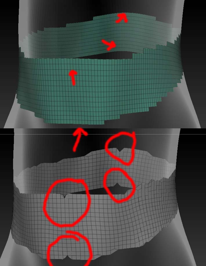

Zremesher problem with edges opening and didn't want that.
The issue is in the picture.
I have a body and I masked it, duplicated it then deleted the divisions and hidden geometry.
I then wanted to smooth it and reduce the mesh with Zremesher like I seen and videos and have
successfully done with a few other pieces on my model.
But this particular piece and another are making these openings in the front and back.
So with that said, could someone explain to me what I either did wrong or haven’t done correctly?
Thank you.
object has overlapping geo from the looks of it. Try a mirror and weld
Thanks a mil!
