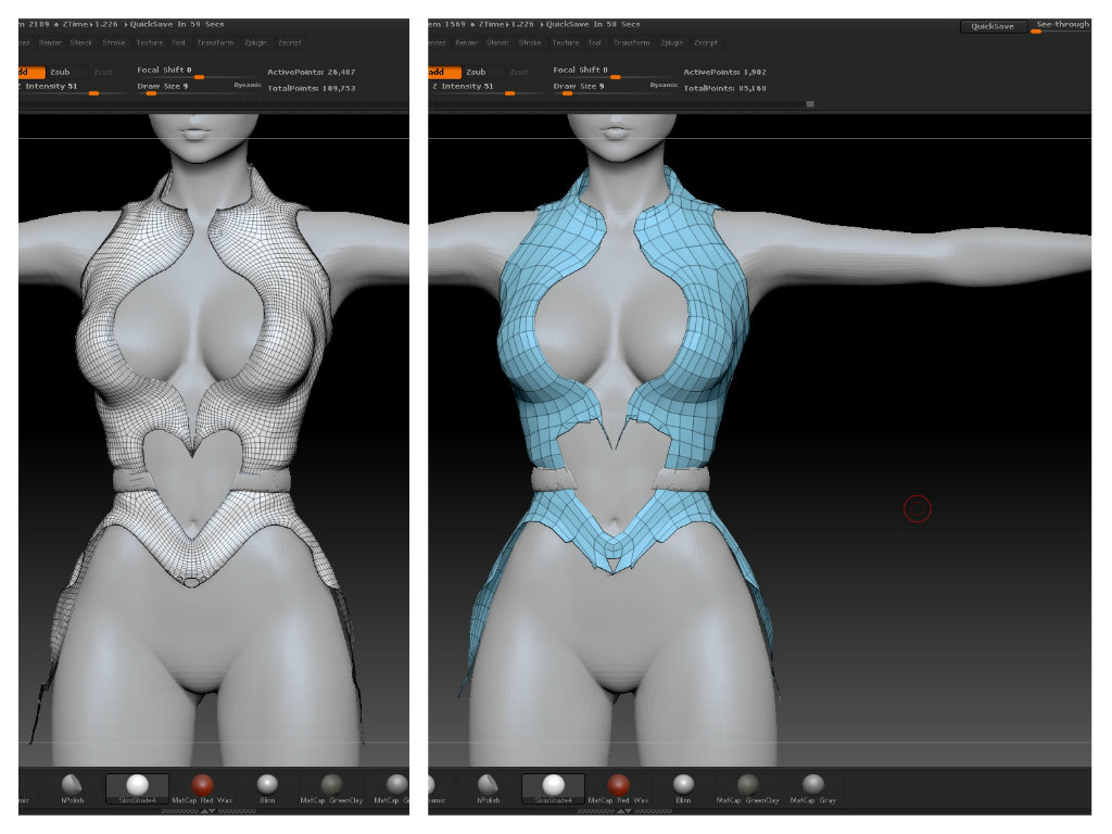

So i already made a suit for my character i was following this tutorial of his: (Link below)
>> https://www.youtube.com/watch?v=A4KzKXEs2Zk <<
Time: 7:48
when i click the Zremesher my suit turn to crap? Why is that so? I turn my “TARGET POLYGON COUNTS: .04” as he say but unfortunately it’s a disaster but when i increase the Target polygon counts it take less disaster. The polygon is much more smaller, and that’s not what i’m looking for i want to do what he have done in 3DS max Time: 9:24.
What is ZRemesher by the way? I’m asking so i have a better understanding/knowledge for people who have experience. Please don’t be mean. I know it’s a stupid question.

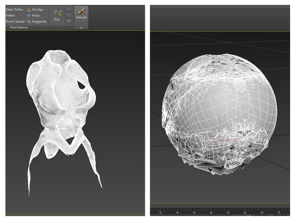

3DS MAX! Shell Extension!! What happened?
Also i don’t know if this is the right thread/site for asking this question but whenever i add Shell extension to my clothes in 3DS max my suit look’s crap again -_-
Also the same Youtube tutorial.
Time: 9:24
Think you need to adjust the shells “inner” and “outer” amount under parameters.
@Synn Thank you very much for your response i will try that after i have the solution on my first problem. Can you answer the first problem i am talking about? How do i fix the model without making my model a disaster through ZRemesher?
W/O pic’s I can’t tell, but by your question make a duplicate of your suit, zremesh the original copy then subdivide it up to about the same poly count( doesn’t have to be identical ) as the copy, then project all. Hope that helps.
