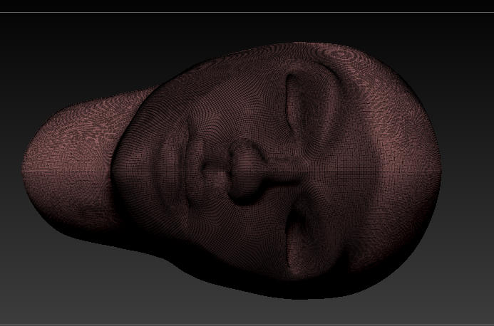

I would like to reduce polygon count only for areas that do not need detailed sculpting. I have e.g. a head and I do not need the back side of the scull to have high resolution since It is a part without any details. Is it possible to reduce the polygons only in this regions?

Hello @Mirko
The answer is “Yes, but…”
There are a number of ways to quickly do this. Currently, the Tessemate feature is very useful here. Check out that video. You can also use ZRemesher locally by hiding all but the mesh portion you want to remesh, and enabling “Freeze Border”.
If all you need to do is reduce polycount while keeping detail intact, say for a 3d print, then Decimation Master is the way to go. DM will remove points where they are not contributing to detail, while keeping the detail intact.
However, any method that only re-wires a portion of a mesh independently of the rest is going to produce some pretty ugly topology that may not work well for sculpting, or many other processes. They should be viewed as quick and dirty, or temporary procedures. This may be suitable in the short term depending on your need, or for 3d print projects that don’t have many topological concerns, but for a quality mesh for more advanced uses, you will need to eventually re-mesh the entire thing with more deliberate topology.
If you’re still going to be remeshing frequently, for instance, then the entire mesh will just be done over anyway, and you will lose that local reduction.
The best way to do this, when you’re at a stage where you will no longer be frequently changing the mesh’s topology, is to ZRemesh, or manually retopologize a new low poly mesh with clean topological flow and evenly distributed polygons, mostly quads, as close to square shaped as possible. This is the best possible form for getting the best results with ultra high detail sculpting, painting, and texture and displacement map creation in Zbrush.
When creating this topology, create it in such a way that more polygons are delivered to high detail areas, and away from areas that dont need it. When subdivided, the areas with more polygons will be able to hold finer detail.
