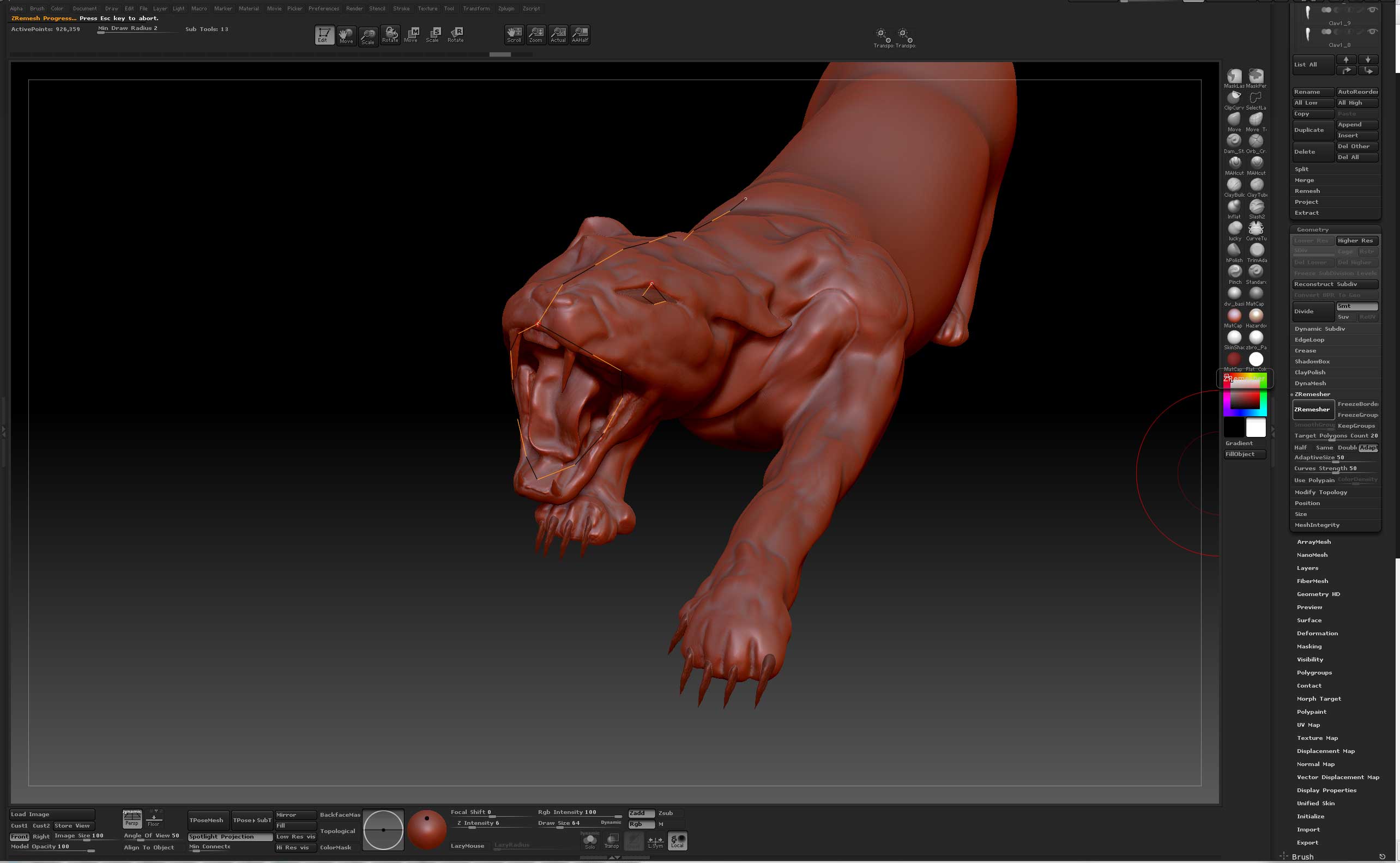

Hi,
When I try to draw with Zremesher brush the curves don’t come out like curves just very line-line-line-line?
Is there anyway to adjust things to get them to be more curvy?
Thanks for any advice.
Hi,
The lines you are seeing are dependent on brush size, so if you shrink your brush each “step” will be closer together.
Also, since making your brush size tiny can cause it to be harder to draw straight lines you can use the 6 key to smooth them out.
Thank you very much. Got it working now.
