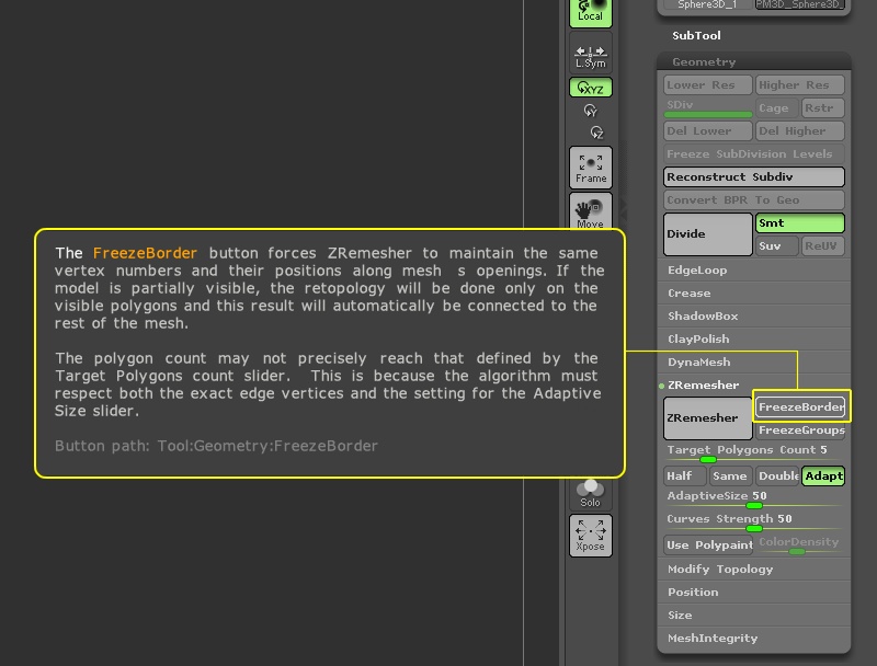

have you already press freezeBorder?
Nope, I was hoping there is something like this.
But… where is this freeze borders? Update: I’ve found in decimation plugin.

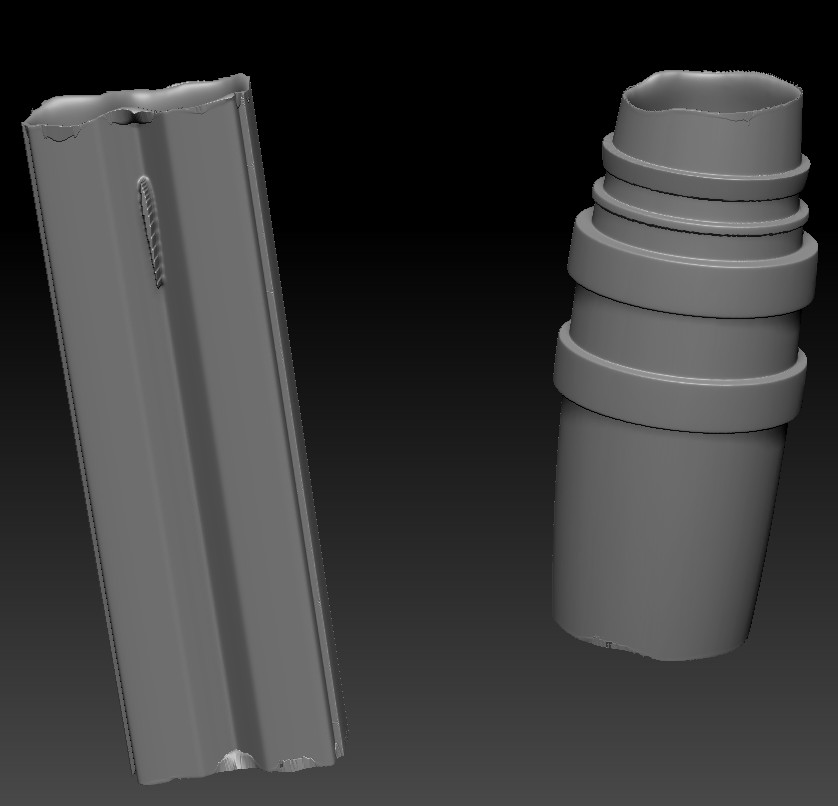

It still looks like this:
Maybe freeze borders is also somewhere else?
Creating sound geometry is the preferred method. Looks like that tool is made of 2 parts you’re trying to remesh. Maybe you should split them up. Using delete loops in the geometry panel can be helpful. You can readily smooth an object once it’s created. Work low res to high as much as you can.

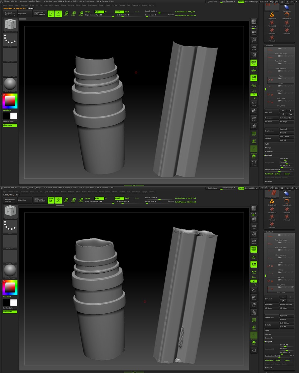

You’re right. From disadvantages of zremesher, I don’t see symmetry options. I’ve made some topology tests.
Results below.
