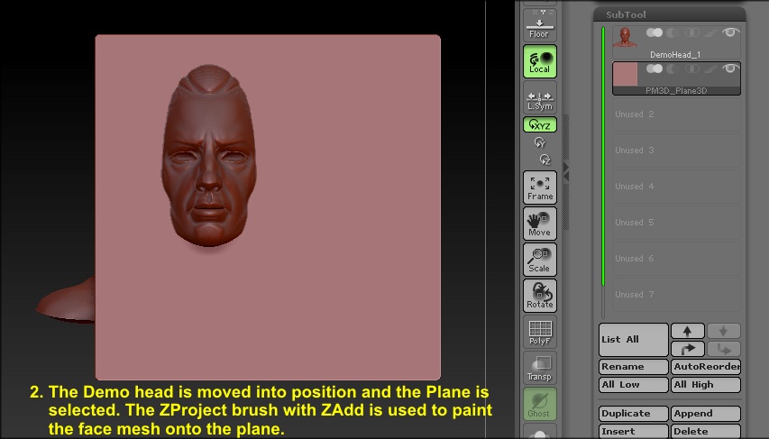

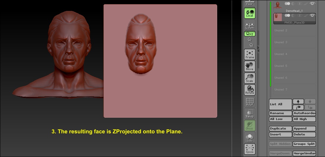

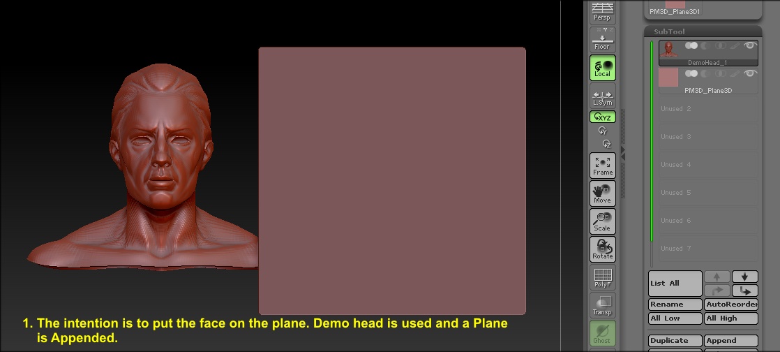

Just to clarify the ZProject brush for anybody that is new to ZBrush.
