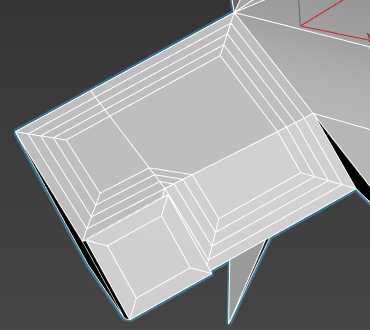

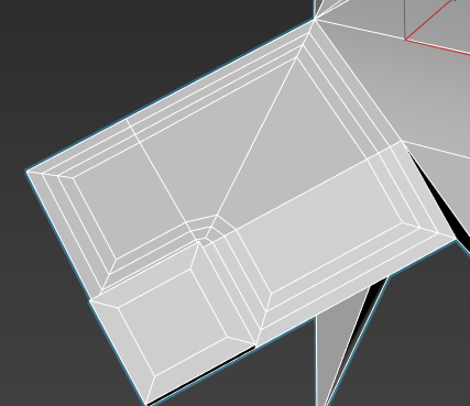

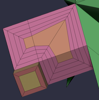

What is doing Zbrush is a not good implementation of the inset.
This is what Max does, that is OK in planar models but not in not planar

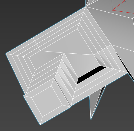

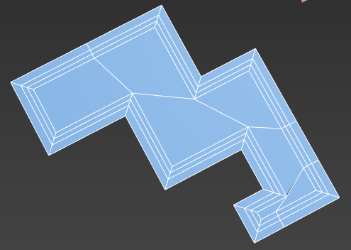

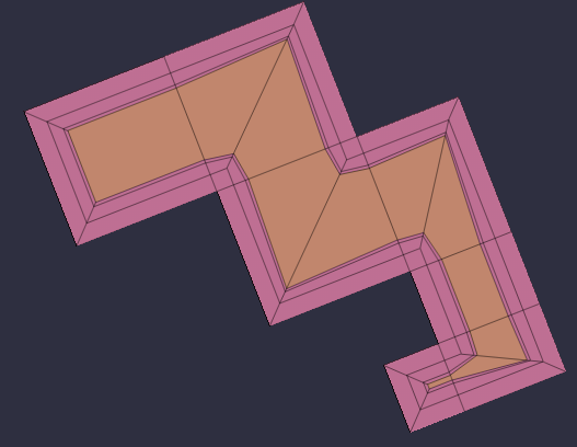

With the Miauu script Inset Pro with edge constrain active and with-wihout quads option and works the same with planar and not planar models. It keeps the same distances.
There is already a solution, you got the ctrl + inset and shift+inset in most case it works but there is also a solution when it doesnt work, just use the transpose master with scale if you control +clic one of the circle you can force a proportional inset.
I didn’t quite understand what you meant, care to do a few screenshots?
