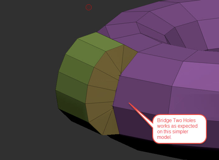

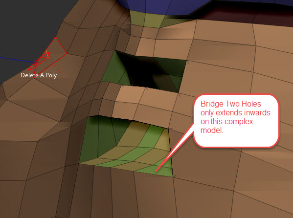

I have a closed subtool with 1,100 polys. I am trying to use ZModeler, Edge Action, Bridge Two Holes. I want to make a round that protrudes the outside of the model. For some reason the bridge will only build towards the inside of the model. I do not have this problem on simpler models.
Is there a fix for this?
Hi - I just had a similar case. The bridge defaulted to an internal route but if I dragged in the “correct” direction it can be routed outside the structure. I am still working on how to repeat several such bridges, all the same size?
