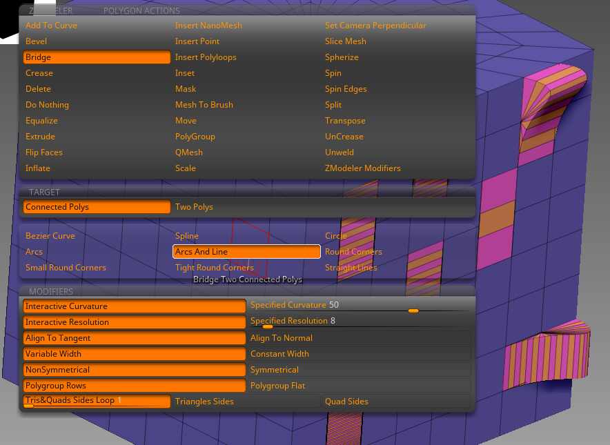

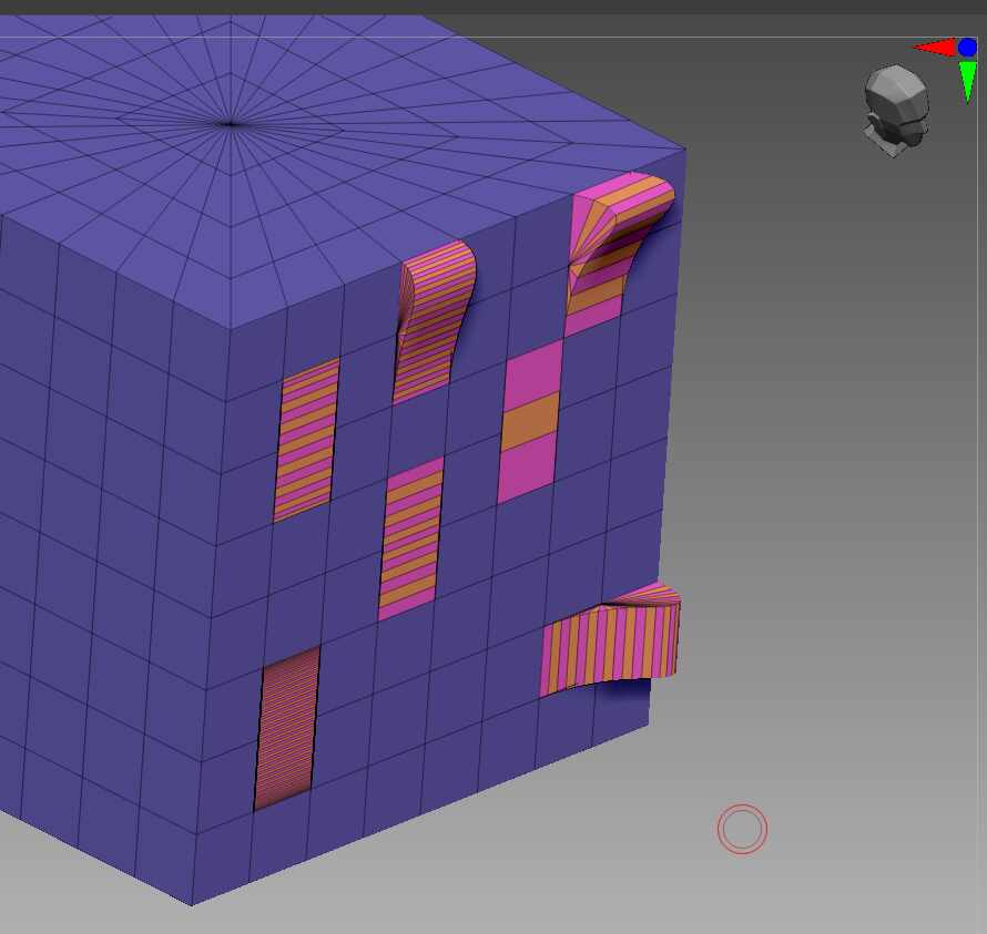

Attempting to bridge two connected poly’s does not create arc. The poly’s are connected but the connection remains flat to surface - UNLESS I attempt where one of the poly’s is located at an edge then it sort of works. Two images below show my settings and the various results I have been getting. This is very frustrating. I have used this successfully in the past and now it is not working. Any help?

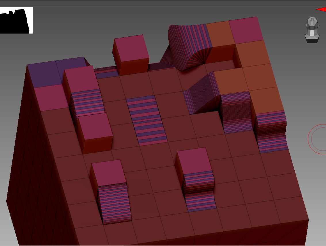

[Edited to add screenshot showing what happens when I try to bridge to poly’s at 90 degrees to each other. NO option will produce a nice curved arch.]

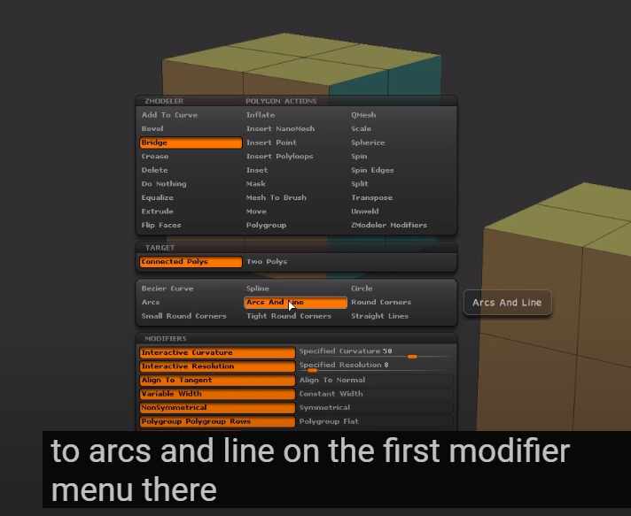

Well, what do you know - it worked… That is very surprising since I normally never even touch those boxes AND when I was looking through videos trying to solve this I came across the below video from Joseph Drust and you can clearly see that the bottom boxes are left at their default settings, including the Align to Tangent!
The geometry Jospeh was working with in that video will perform that way with tangent active. A cube with > 4 polygons on a side will not.
