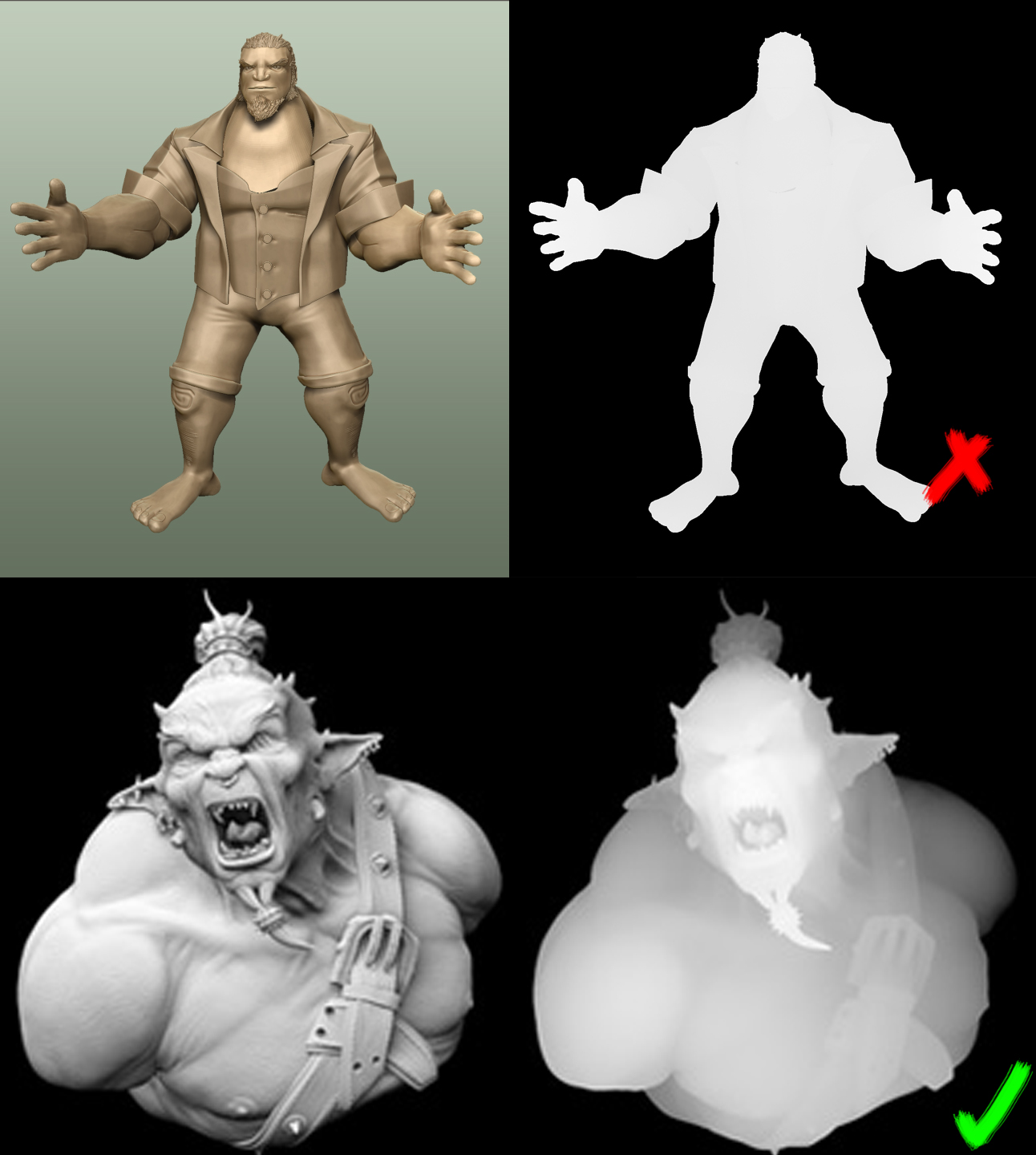

Here is what I am trying to do the image on the top is mine and the image on the bottom is what I want to achive.
Anyone have a guess what I may be doing wrong?

I manged to get it working , I think the problem lies in the fact I use a custom z document ( I find the black one hard to look at ) as when I pressed ctrl+n and used a new/default document everything worked just fine.
I also received some other possible solutions which I am going to post here as It may help someone else in the future
If your alpha is coming out completely black or completely white, there may be a scaling issue in which the scale of your tool isn’t working well within the document. Deformation>Unify can sometimes help with this, but if you have multiple subtools you’ll have to merge them with SubTool Master first. Give each subtool it’s own polygroup, merge everything with subtool master, unify, then break it back up into subtools if you wish, using the polygroups to aid the process.
