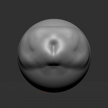

Is there a way to disable the Angle Snapping (green line) of the Lazy Mouse Tool in ZBrushCore?
It keeps snapping on 0 and 45 degree angles, and it makes me unable to use the tool right now.
I tried to adjust the settings of the Lazy Mouse Tool, but no luck…

Sadly, this is not the case with me. I just tested this out:
Opened ZBrushCore -> Changed the LazyRadius to a higher value (60) -> Painted with a default brush.
The green 0/45 degree green lines keep on popping in while painting. I dont hold the shift key, I am just painting with everything on default.
Below is an image of what I see:
Hope this helps in building a solution, or figuring out a workaround,
Thanks!
Danny
OK, I can reproduce that. I think it’s intended behaviour. The point is that if you extend the Lazy Radius you are after a more precise stroke, so it makes sense to display the angle and provide snapping.
