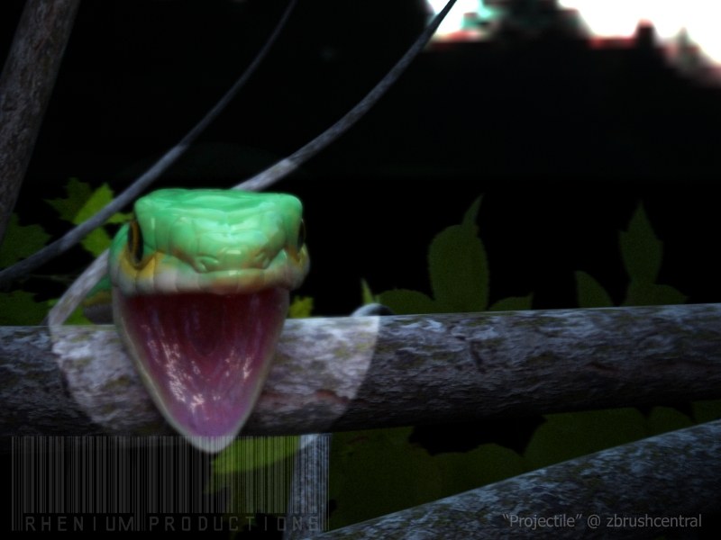

i am still using the same settings in vraydsplmod that i used with dspl maps from Zb2.
basically the amount:shift ratio is to be maintained at 2 : (-1) for displacement maps from Zb.
eg 10:-5 ; 20:-10 etc
“Amount” is the hieght that goes up and “Shift” is a negative value that goes down.
the exact values of amt and shift needed to give a 100% representation of Zb models need to found thru trial and error but always maintining the above mentioned ratio.
take care that some value might look very good but your resulting model might be a bit bigger that the original intended model (as in problems with cloth etc.) in such cases its advisable to model you low poly base mesh a tad bit smaller than your references and use the references again when finalizing the displacement amount.
i have brightened up the model and attached a frame of animation being worked on now(shader testing), have a look. i am persanally kinda happy with the displacement, but still it looks better in ZB.
will post the settings screen cap soon
hope this helps.
