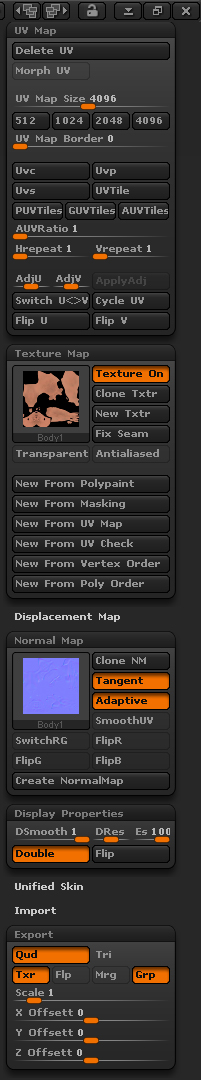

Goz works pretty well as long as you dont require an extreme amount of detail out of your disp…if you do you need a 32 bit disp map… for this I recommend to use the Multimap exporter plugin that is free.
Goz is meant to be one button and done…if you dont get good results then use the standard method of exporting and start from scratch. Don’t try to use Goz and then try to use a different disp map or change a bunch of stuff cause Goz sets thing up to work perfectly with the map IT exports. At least this caused ME a lot of confusion so I would think just start new and at least you will know what settings have been changed because you changed them.
If you still cannot capture the detail with a 32 bit map no matter what setting you use…use a normal map on top of a disp map.

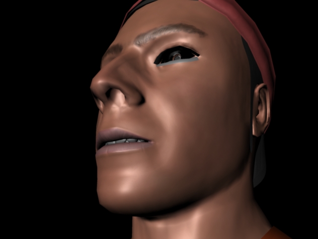

As for myself, I’ve come very close to reproducing the level of detail and quality from my original ZB Sculpt. I tried for a while to successfully build a layered Displacement Map + Normal Map render in Maya, and found that I could never quite get the detail out of it that I want, so I scrapped DP, and went with just Normal maps, which is actually closer to what I will be going for games anyways.
I also started using GoZ (ZB 4 and Maya 2011), which actually gave back great results right off the bat. All I have to do when using this method is adjust the Blinn settings on the materials in Maya before setting up renders.
