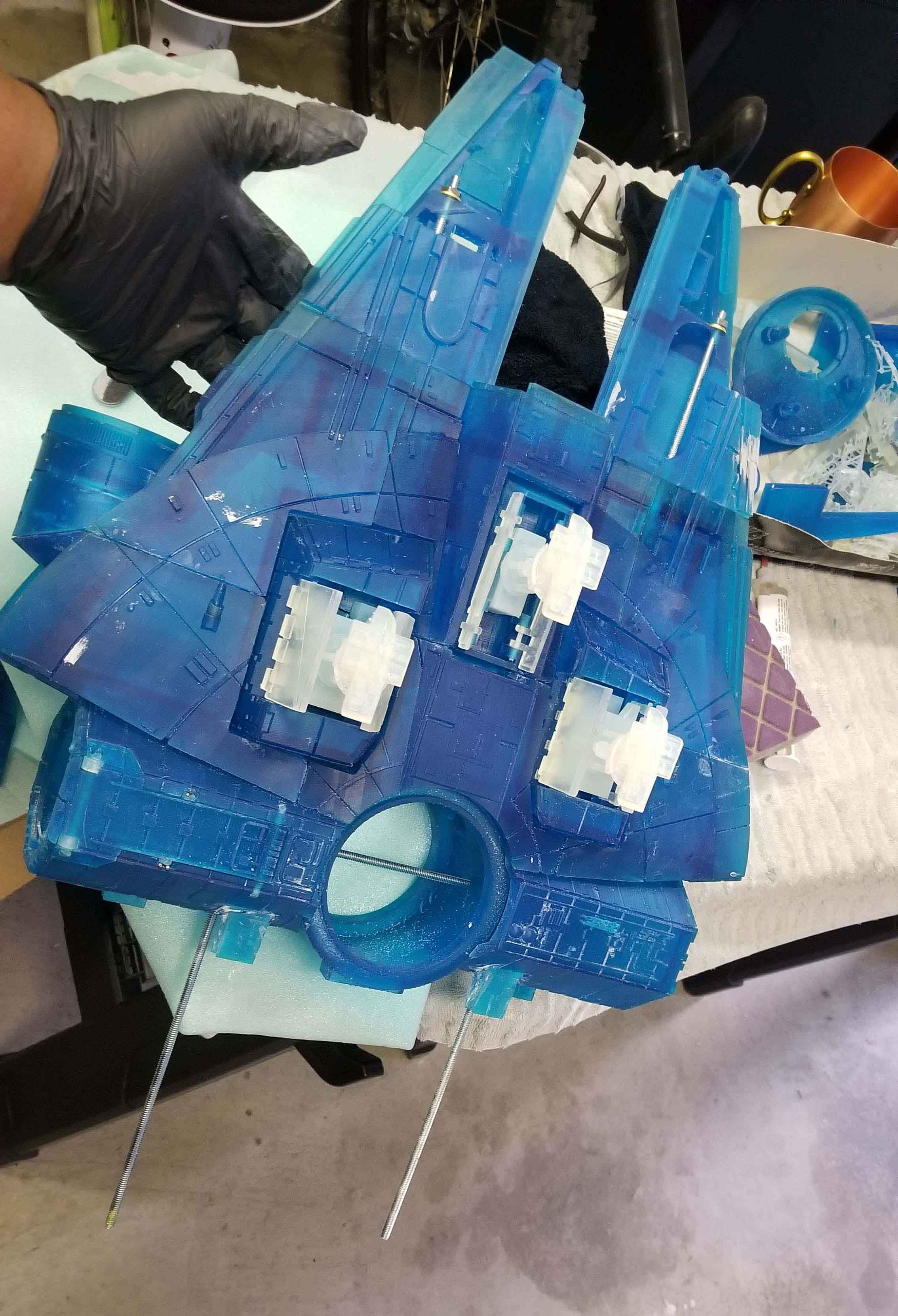

This Falcon consists of over a hundred subtools and 56 separate Formlabs Form 2 prints.
Most of the prints were done with Formlabs Tough V5 resin, as Tough Resin simulates the feel and many of the important mechanical properties of ABS plastic.
Some of the inserts shown in the raw (un-primed) printed parts photos, were completed in Formlabs Clear V4 resin.
Finally, the landing gear and landing gear bay doors were printed using Formlabs Durable V2 material, as it is Formlabs most impact resistant material, Durable Resin is also highly wear resistant, and capable of extreme deformation before breaking. Durable V2 resin also has low friction compared to Standard and Tough Resin. Thus, this material is great for carrying the weight of this prototype, as well as handling the open/close swiveling of the landing bay doors.
