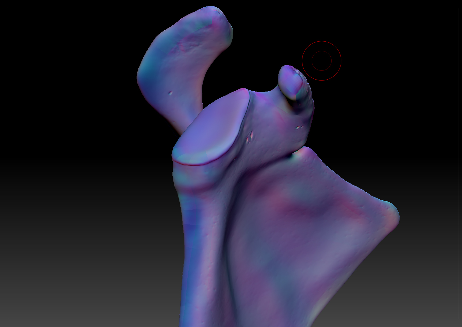

Hey guys i got a simple model am painting in zbrush that am trying to get some normals from, so when i create the normals and view them its showing my seems, but in my poly paint i dont get any seems, so i go to 3dsmax 2012 and apply the maps thinking its a zbrush viewing issue, but when i apply the normal map in 3dsmax i get the same issue, i see all my seems, but in the texture map i dont see any. Anyone have this issue? Or am i doing something wrong? The uv were creating in zbrush also.

I am not flipping anything because when it comes back to max its correctly flipped, but i am using local space instead of tangent, because tangent looks worse, here is a quick render, these uv were done in zbrush,alos something else am noticing is that in some areas you could see the low cage coming through the normal map, i just posted another thread about this because i cant seem to generate smooth normals anymore,

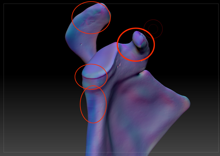

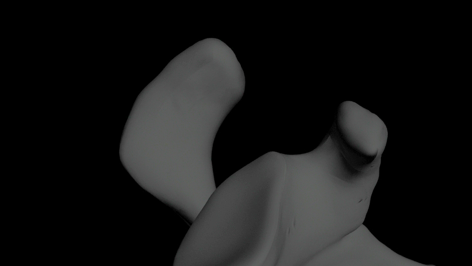

none of the normal maps am generating are looking fine i see all the seem lines from the UV. what i mean by being smooth and un smoothed are highlighted in red. Now what am getting when i create a normal map is in the second image_smoothed UV is check and Snormals also checked. Also the third image is a render in max showing the seems.
