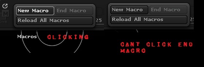

And I dunno why I cant make a New Macro
I just click and nothing happens.
What is wrong :(?
Thanks for your help. :o

What do mean ‘nothing happens’? Pressing the ‘New Macro’ button starts macro recording. You then do whatever it is you want a macro for. When you’ve finished you press ‘End Macro’ and save the macro. It will then be available for you to play back whenever you want.
Beggining.
New Macro is Light gray and End Macro is Dark Gray.
I Click at New Macro gets white
But the buttom still Light Gray.
If I try End Macro,I cant because the End Macro buttom still dark gray.
It seems it did not Start recording.
I’ve not come across this issue before. Please submit a ticket at Pixologic Support explaining the issue: https://support.pixologic.com/

I discovered how to record with macro…
First I need to click new macro and end macro.Even NOT working.
So I “save”.
And When I try again…It works…
The unique problem is, I cant find where to open my macros saveds…It not appear at the list and I used more than 8 charecters.
Save them to the ZStartup/Macros/Misc folder, then press Reload All Macros. You’ll find your new macro button in the Macro>Misc menu.
Ok Thanks
I was not saving at the Misc folder.
It is just boring that I need save something before my macro start working :td: :td: :td: :td: :td: :td:
Thanks!
