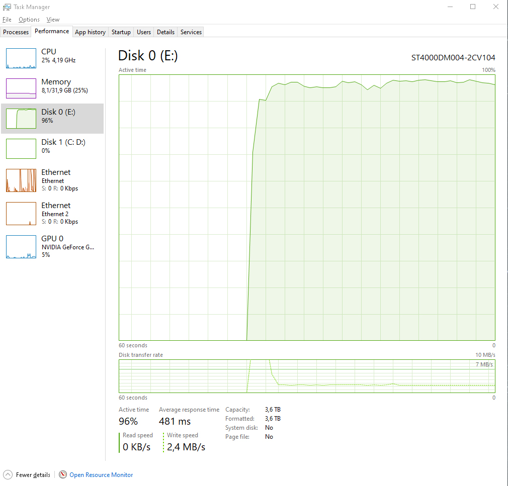

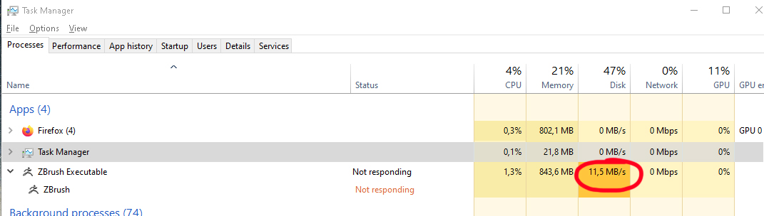

did you find any solution for this problem because i have same thing with zbrush 2020 apparently with all files old or new
had that (same?) problem
I cleaned the ZBrush Temp , VMem and Quicksave then I went to :
Preferences -> Mem -> CompactNow
I let ZB processed then restart it.
Worked for me, hope it’ll be the same for you
