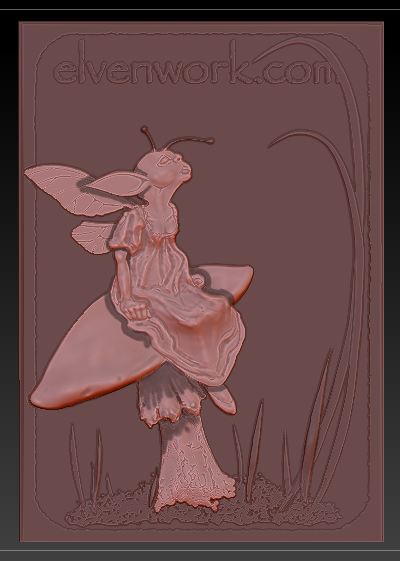

I’m a rank novice when it comes to this stuff, but in my experience so far, the Deformation Submenu’s ā€œFlattenā€ will not produce the effect you want. Careful Masking, the Inflate, Clay, Standard Brushes with the Z settings set very low will give you the control you need to raise the relief gradually. Here’s a relief in progress done with a 4 grayscale image Alpha and the techniques mentioned above:BasReliefDewey.JPG

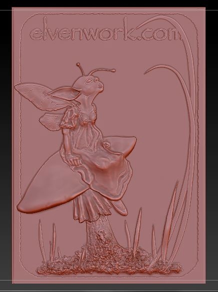

It took longer to selectively mask the background than it did to raise the relief. I was constantly masking and unmasking areas as I worked. I also used shades of gray, rather than just black on white, in the line art so the lines in the face and dress of the sprite didn’t cut too deeply. Setting Z value to 4 did most of the work; the letters, frame, and most of the blades of grass remained untouched and were masked at the outset. Here’s a screen capture of what I call selective masking done near the end of the process: Card7.JPG

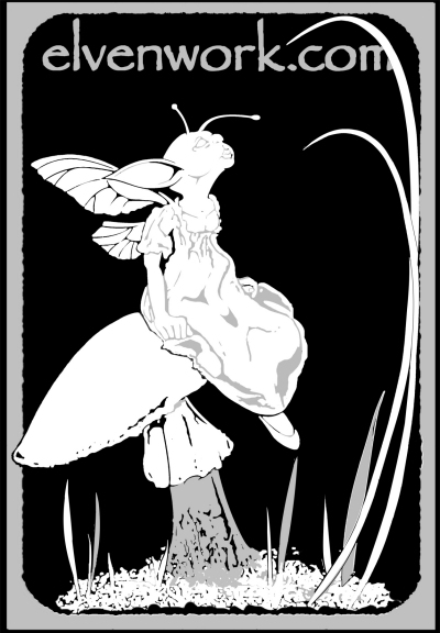

I love Bas Relief, and so wanted to see if I could do it in ZBrush. This was my first relief and it took three attempts before I understood the tool needs to be subdivided (maybe 4 times), the real power of masking and that a light to mid-range gray in the Alpha would be helpful. Here’s a dumbed down close-up of the original template without the square black background to show you what I mean:
Note the gray musroom stalk, leaves, letters and frame, as well as the lineart within the sprite. Oh, the original template was huge.
