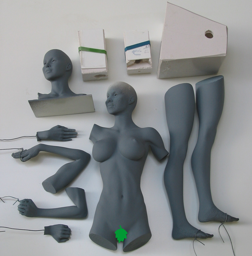

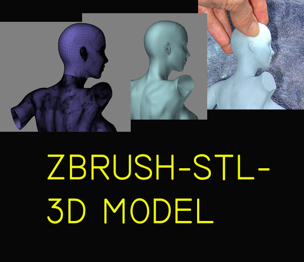

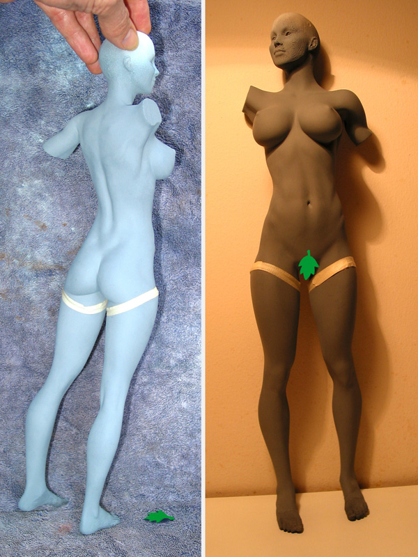

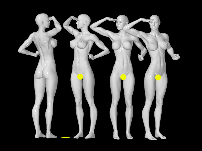

Its taken a while but I’ve made some progress. The photos show the Zbrushed figure, a basic poser one I made into a more muscled type.
The figure was cut into the pieces you see in the group shot and printed
in styrene for the body, legs and arms. The head and hands were printed
in wax. I put in a few photos because its hard to explain how it all comes
together to some people. Thought maybe the non CNC nuts
would like to see even more uses for Zbrush.

Very cool.
3d printing?
What brand of 3d printer? Any post processing?

billrobertson42 , yes lots of very fine post work. I don’t remember the exact
model of printers…if I quote it maybe wrong. Will post finished pix soon.
David
