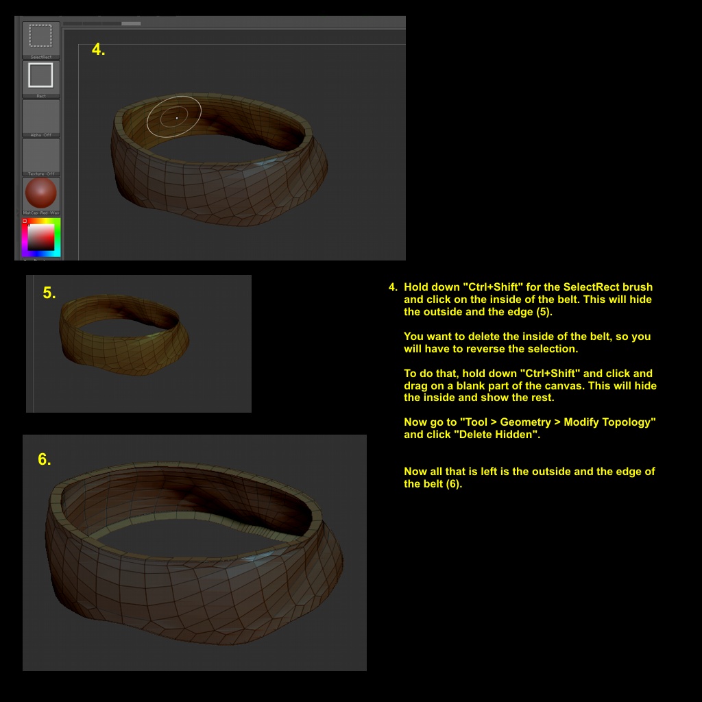

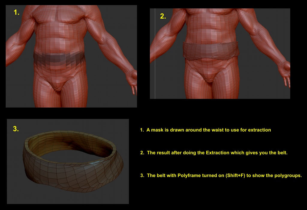

I will try to explain it a little better in the following 2 images. Hope it helps.
Thanks zber2, Great tut!
Thank you very much zber2!
No problem!
Thanks for this, I really appreciate the visual tutorial!
