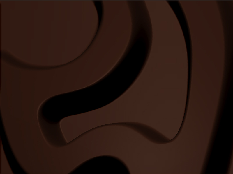

So, when i use alpha i get this:

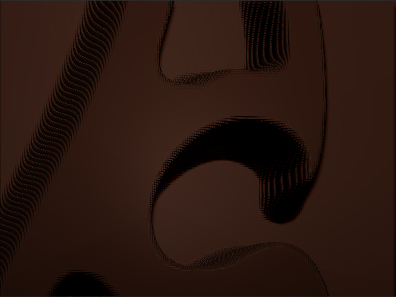

But if i use stenicl i get this O:
Why?

Hi.
I’ll be short (even because my english is soooooooooooooo broke :look: )
Why?
Thanks for the attention
If the alpha that you use for the stencil is 8 bit then you might get that stair-stepping. But also the density of the mesh will affect the result. Try dividing the mesh to see whether you get a better result.
The polycount is max, cause i have another issue (http://www.zbrushcentral.com/showthread.php?177738-Zbrush-4R2-use-only-2-GB-ram)
So i should try whit 16 bit alpha?
