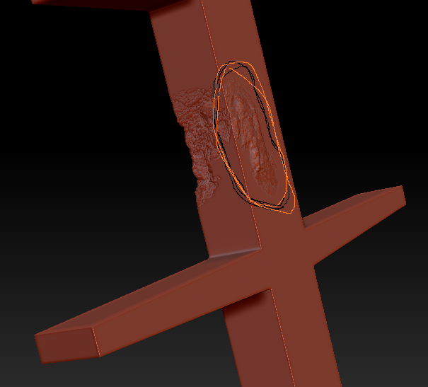

Hello, it comes out from behind the object when using my brush.
You can see this problem in the photo.
How do I fix it?
Hi @Enes_Saka Welcome to ZBrush Central.
Go to “Brush > Auto Masking” and turn on “BackfaceMask” to prevent your brush from sculpting on the back side.

Very Thanks @zber2.
Problem solved.
