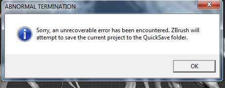

Anyone having a problem like this: I load a project and when using transpose master or sometimes opening a project followed by other, the program freezes and this message appear,
the program shuts down and I can’t do nothing. I already try uninstall and instal again, did not work,

Crashes will occasionally happen now and then. The question to answer is if they are repeatedly happening with a specific tool, or with a specific operation.
Now in the third reinstall I see that it is only happening with one tool when I’m going to use the T pose Mesh…and yeah every time I tried to use this tool and Tposemesh
maybe some conflict or error with the tool itself?
Most likely. Geometry can become problematic or crash-prone in a number of ways.
If you’ve isolated a repeatable issue, we would need to take a look at the tool, how large it is, and what you’re trying to do with it.

So, the tool has 10 subtools, 2.03 mil points and 51,4 mb in the disk space.
When I open in 4r7 version and try to do the action with the transpose tool, all works fine. Seems like this happening with me with the latest version. I dont know if this is a problem with my own instalation, I have installed some scripts, macros and other useful things as well…
I’m trying to use tposemesh just to combine the tools and make some pose experiments with the character
Can I send you the tool for you to check it out?
Can you reproduce the issue without fail in a specific situation? If so, that should be sent to support so they can identify the problem.
I understand, the error is happening all the time with this action and tool. I will see a little bit more if I can solve this on my own, if not i will send to the support then.
