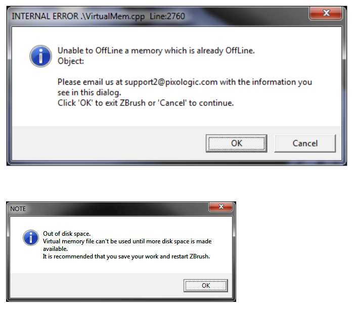

I installed the r4 update while logged into my computer as myself, and my supervisor assures me that I am setup to be an administrator on this box. The install went smoothly, but I am seeing some errors after working for a couple of hours on the same file. See below.
The first error occurs when I try to save a file with approx. 1.54 Mil Total Points. The second error occurs when trying to open a different file (.zpr) that I have already saved. It too has about the same number of points.
I went through the .pdf you cited and then changed my scratch path by editing ZBrushScratchDiskPath.txt, and pointing it to a drive where I have my other programs scratch disks pointed. After a restart the above two errors persists.
Is my supervisor lying about me having admistrator priveleges on this box? How would I check? I am able to right-click on programs and select “Run as administrator.” By the way, I tried this with ZBrush 4 r4 and it had no effect.

I am fairly certain that I am indeed an administrator on this box. When I go to Control Panel\System and Security\System I am able to click on the Change settings link. I can change the name of the computer in the Computer Name tab that appears.
So, I believe that I am indeed an administrator and that I installed ZB 4 r4 as an administrator. Am I in error, or is there another method to solving these memory errors?

Update: I found the problem. Even though I have full admin privileges on my Win 7 machine, I still need to run some installers as admin–I think what happened is that ZBrush didn’t have permission to write to the directory, and subsequently other functions such as virtual memory. Anyhow, the solution, as Will Miller in Support so helpfully pointed out, was to do a reinstall running the installer as admin. That seems to have fixed the problem.
I deactivated, uninstalled, then reinstalled. This time, however, I reinstalled by right-clicking on the installer and choosing ***8220;Run as administrator.***8221;
The problem persists even after this.
Contrary to my earlier post, the problem may be fixed.
It seems that I can create new files, and open and close them, without incident. However, the files I had created while running the ZBrush r4 install without running as administrator, seem to be corrupted.
So, running the installer as administrator even though you have administrator privileges is advisable it seems.
Good luck, all.
